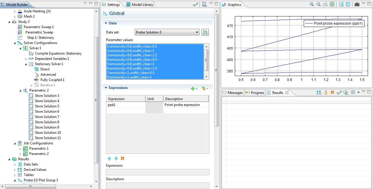

I could manage to get the desired plot, but not in a "comfortable" way: I am using different studies for one parameter (e.g. emissivity), which I have to change by hand. In these studies I make then a sweep for the second parameter ( e.g. beam length). As a result I get different solutions which I can combine in a plot group.
As the beam length should have a higer resolution than the emissivity (3 different values are ok), this approach is reasonable for me, but surely there must be a better way.
I guess you mean, I should do 2 parameter sweeps in one study?! I did, like shown in the attached screenshot. The sweep itself works, but if I want to plot, I can not select the results belonging to each parameter (e.g. emissivity). Just all results are plotted in the same plot.

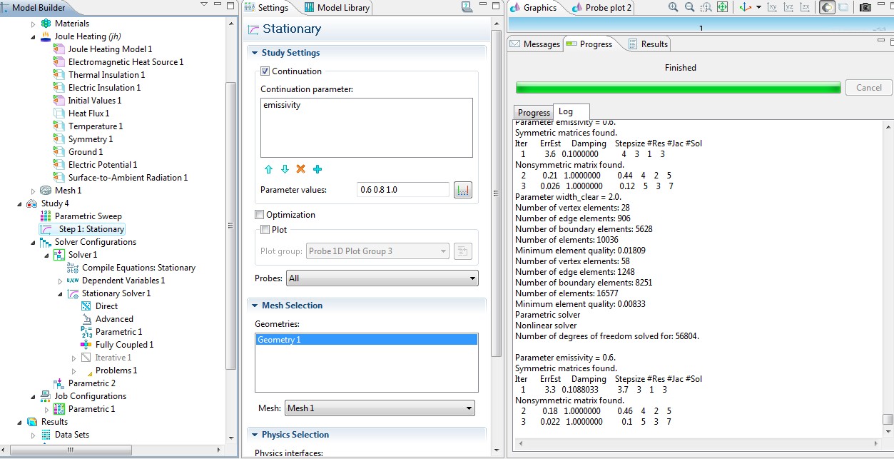

I understood and implemented your idea with an outer "parametric sweep" and an inner "continuation parameter sweep".
Unfortunately, a solution could not be found. The solver starts, but stops with this message:
Invalid property value.
- Property: solnum
'Solution' is an array of integers.
I tried all direct solvers with different tolerances (0.9 - 0.001) and also refined the mesh (minimum element quality now0.0083).
For a "manually sweep" on the other hand, with all the different combinations I could find a solution.
Any ideas?

I do not think that is from the method, for me it's a weakness of the 4.0a fixed in latest 4.1 about how v4 should "refresh" a study when the solver sequence already is there.
In v4.0a my way was to systematically DELETE the solver sequence and rebuild it (either automatically or by hand) from scratch. This implies also delting all solutions and plot settings.
Since I'm using 4.1 the *automtic" feature of COMSOL overcome this. That was my experiuence with the "solnum" error. So I can only advise that you try too, save your file into a new name/new fileversion and delete all solver data and restart rebuilding the solver sequence and then solve + remake your derive values and plots
The best get your hands on v4.1 latests patch it's much more stable and free of these issues, plus it has a cut&paste functionality operating, CNTRL-Z saves a lot of time ;)
