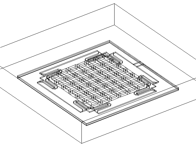

I have modelled a MEMS resonator and am trying to plot the variation of capacitance with the applied DC bias using Electromechanics. Starting with a 3D Stationary solver (owing to the perforations in my structure) modelling it in 2D would not estimate the real behavior, I get the following error, despite specifying the Boundary conditions properly.
Failed to find a solution
Segregated Group 1
system matrix is zero.
As attached in the model file, I have created selections for Resonator, fixed electrode and air for convenient selection of boundary conditions. Besides, I have included a .jpg version of the entire model for convenience.
