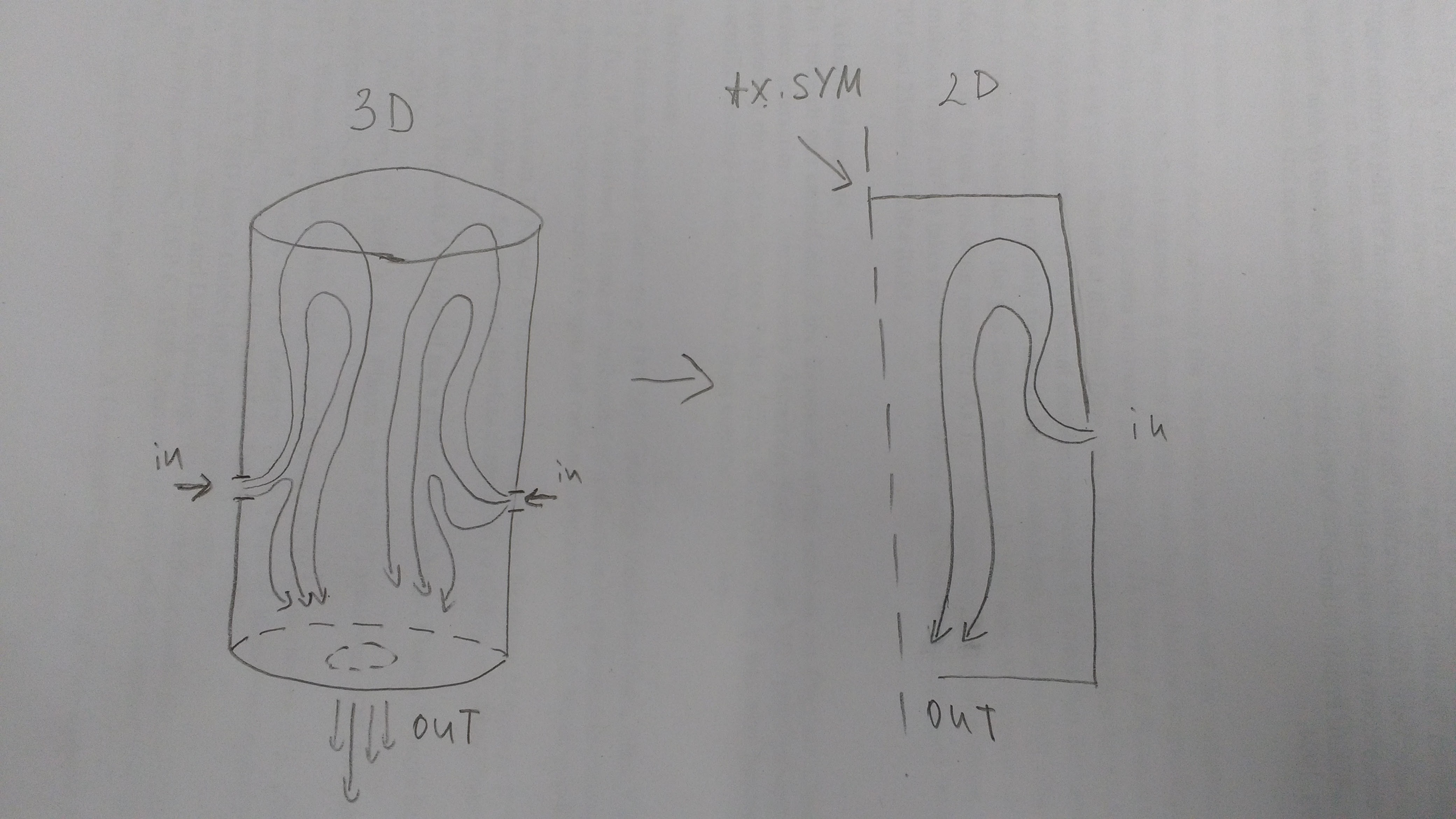

I have the following problem: I have a 3D simulation of a gas flow in Comsol 5.0. Now I want to add some heating effects, but as the geometry is cylindrical, a 2D axial symmetric model will do as well. How can I incorporate the resulting 3D flow solution (translated into cylindrical coordinates) into another study in 2D? I tried the "extrude" option, but I could not figure it out.

Thank you for the reply. I've been looking at these tutorials for quite some time, but it is still unclear for me how to perform this simple task (see attached). Ok, I can assign the extrusion, and then? Where does the data go? I assume I should define a new component, which is 2D axial symmetric. Then, how do I take the data for the new solution to use? Should I define new variables in the new component, such as mod1.ux = mod2.ux ? I get simply zero's for the vector in the 2D component. Can you point me to a tutorial model in the library? I think I'm missing something.
