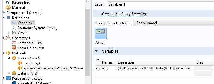

My model is simple triaxial experiment. I defined the porosity change depends on the volumetric strain( poro.evol) in variables as picture showed. The volumetric strain changes with time. The expression is the function of the volumetric strain( poro.evol), but the porosity is still constant and didn’t change as the expression. Is there some problem about my expression?
