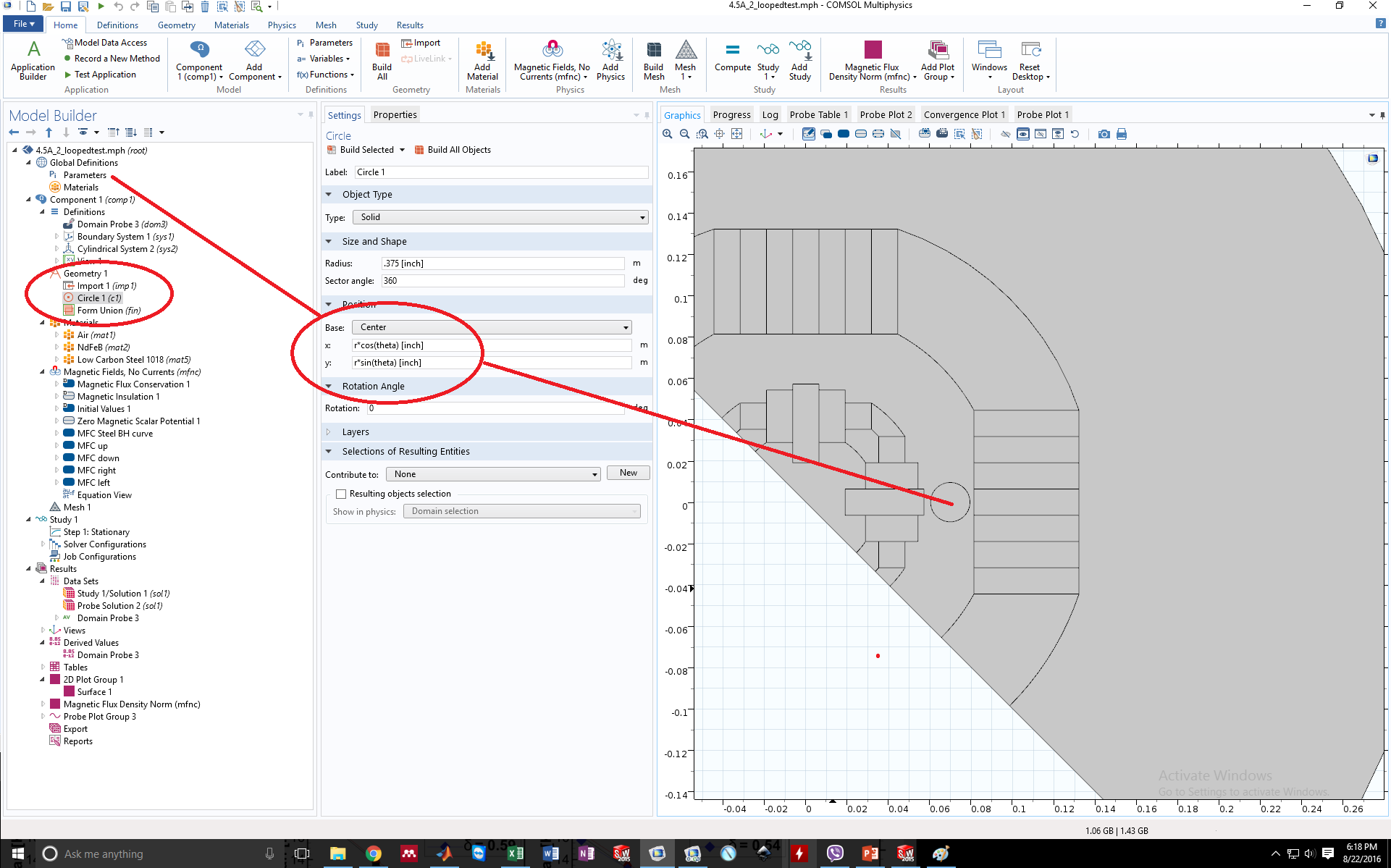

First, take a look at images 1-3.
- I have created a domain probe to find the average value of the magnetic field strength over a circle.

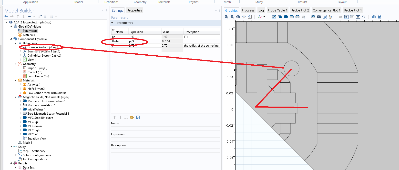

- I want to move the domain which is being averaged from theta=0 degrees to theta = 45 degrees, in say increments of 2.5 or 5 degrees. The probe should be re-evaluated at each location. The result should be the average field in the circle as a function of the circle's location.

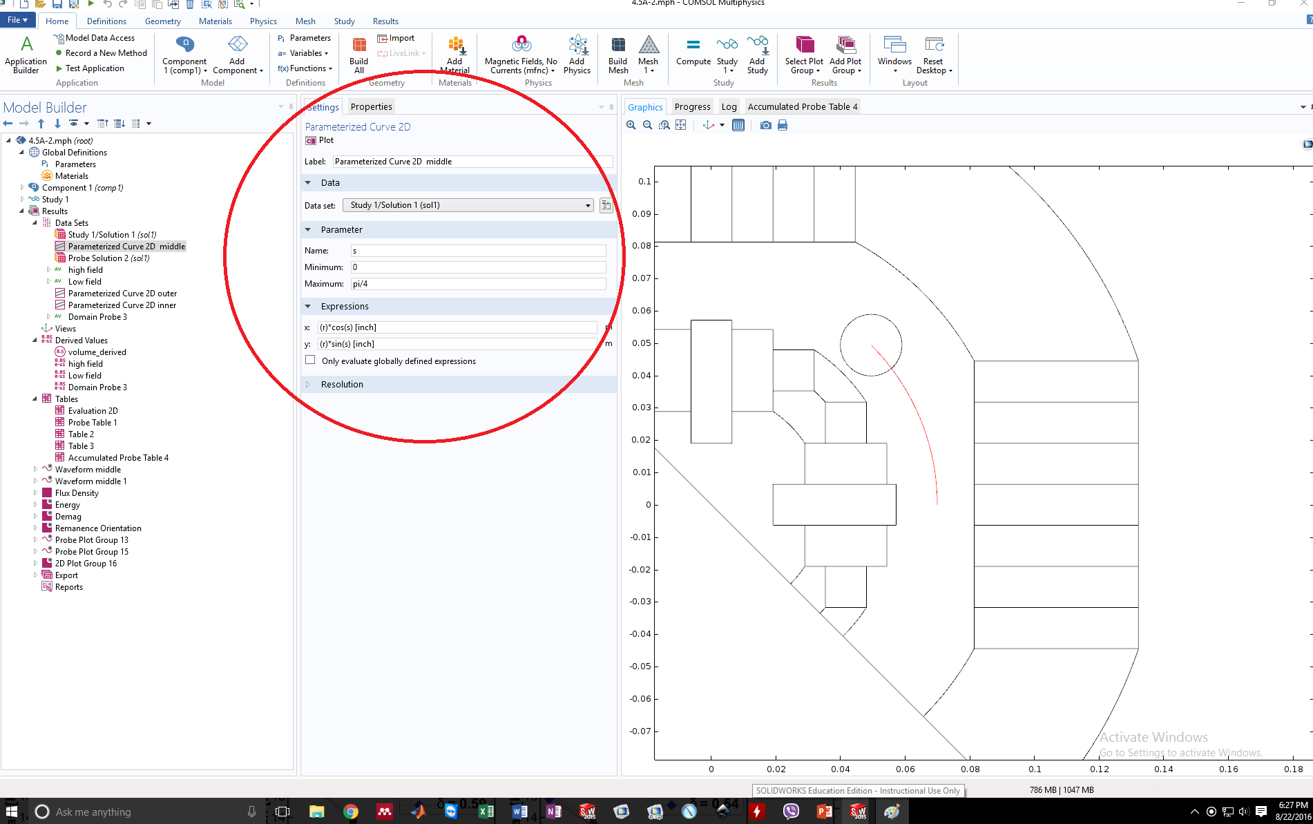

First, i tried to define parametric curves along the midline arc, however this was inadequate for my application (see figure 4).

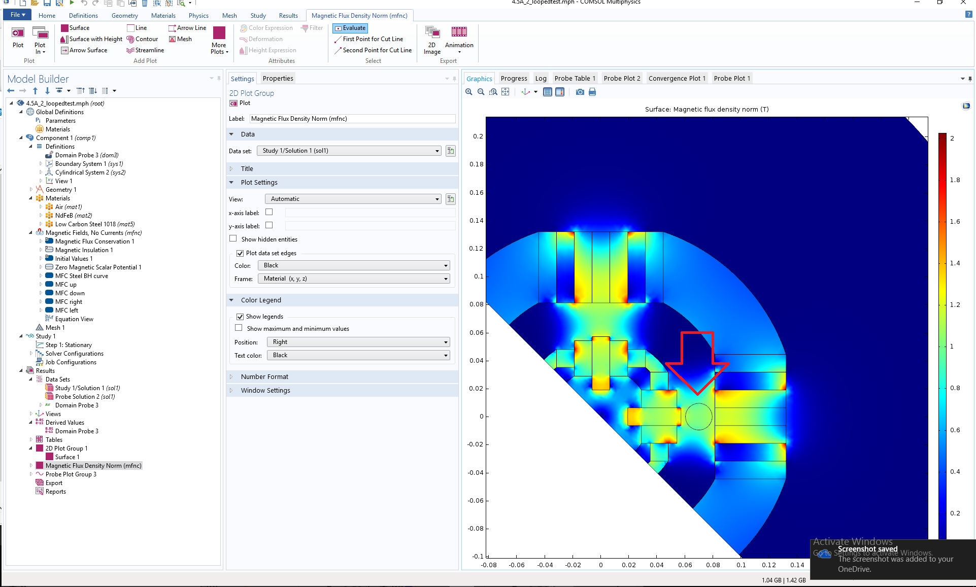

Next, I defined a parameter (theta) and did a parametric sweep. This gave me exactly the output I was looking for - however this required re-solving the PDE for each parameter step. I am hoping to couple Matlab with the model to try some basic optimization, which requires increasing the efficiency of the Comsol simulation.
Is it possible to have a nested solver, where the PDE is solved for the field as a function of space in the outer loop, then my "theta" variable is sequenced in an inner loop, and the average field probe is updated for each degree?
