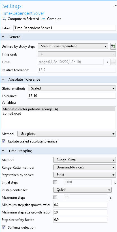

Hi Gennady, the best thing to do here is to switch to an explicit timestepping method. To do this, go to Study 2>Solver Configurations>Solution 2>Time Dependent Solver 1. In the Time Stepping tab, set the "Method" to "Runge-Kutta", and the "Runge-Kutta method" to "Dormand-Prince 5". Accuracy can be improved by setting the "Steps taken by solver" to "Strict".
With these settings, the error drops to around 0.2%. You can reduce the relative and absolute tolerances to reduce the error further. For example, at a relative tolerance of 1E-9 and absolute tolerance of 1E-10, the error dropped to 0.0004% (see attached screenshot of the settings).
This is quite a difficult test case, since the magnetic flux density is on the order of 50[T], which is extremely high.
Dan

Dan,
Thanks, it worked! I am knew to Comsol and haven't gotten to that level of setting control. Now I understand it better.
PS. Just curious - RK methods are known for relatively bad handling of energy conservation. Often, a so-called Boris method is implemented for particle tracing in E- and B- fields. Is there an option for that?
PPS. A field of 50T is high in absolute terms, but I thought that it's OK since in relative terms (the ratio of the Larmor radius to the system size for example) all three cases are almost identical. Or there is anything else that I'm missing?
Thanks again, it's been a great lesson,
Gennady
