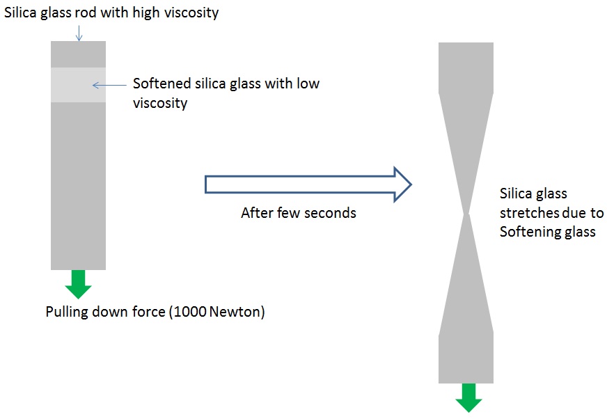

I am pretty new in doing material deformation problem. Here, I would like to model the deformation of a heated glass rod with some softened parts under external force. The schematic drawing is as the attached picture. Does anyone have the idea how to perform this kind of modeling? Any input will be very thankful.

my first guess would be to use ST (structural), + ALE (moving mesh) with HT (heat transfer). It depends somewhat on the data and material properties known for youre meltenglass.
To build the model I would start one physics at the time in that order
Hi my first guess would be to use ST (structural), + ALE (moving mesh) with HT (heat transfer). It depends somewhat on the data and material properties known for youre meltenglass. To build the model I would start one physics at the time in that order -- Good luck Ivar

Thanks for your useful suggestions. If the material will be the silica glass (can be found in the material library of COMSOL), and the viscosity of the softened part of the silica glass is 1e5 Pa*s at temperature of 1100C while the viscosity of the solid part of the silica glass is 1e20 Pa*s at room temperature, how can I start the first structure model?
David
[QUOTE] Hi my first guess would be to use ST (structural), + ALE (moving mesh) with HT (heat transfer). It depends somewhat on the data and material properties known for youre meltenglass. To build the model I would start one physics at the time in that order -- Good luck Ivar [/QUOTE] Dear Ivar, Thanks for your useful suggestions. If the material will be the silica glass (can be found in the material library of COMSOL), and the viscosity of the softened part of the silica glass is 1e5 Pa*s at temperature of 1100C while the viscosity of the solid part of the silica glass is 1e20 Pa*s at room temperature, how can I start the first structure model? David

Unfortunately, I still have no idea how to deal with this large deformation problem.
All the best,
David
[QUOTE] Dear David, did you manage to model glass rod deformation? Can you share with your experience? Thank you, Kanat [/QUOTE] Hello, Unfortunately, I still have no idea how to deal with this large deformation problem. All the best, David
