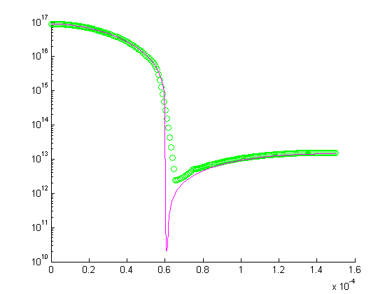

i can solve my semiconductor model with a relatively coarse mesh.
However the found solution is not good enough. It shows some
differences to a reference (PC1D) semiconductor model.
That is why i want to refine the mesh.

I found out, that the problem especially occurs, if i refine the mesh in a region with large gradients.
The Comsol solution is represented by green circles and the reference solution is shown as line in the attached figure.
Has anyone an idea how the finer mesh causes "undefined value"-problems and how to overcome them?
