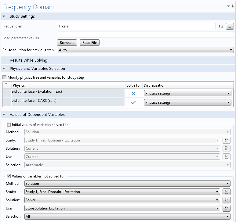

In detail: I am modelling a nonlinear optical process enhanced by a nanoparticle, see model attached. I use the wave optics module with frequency domain interfaces. In a first study step, I compute separately the field distribution created by two laser beams at the frequencies f_pump and f_stokes respectively. I can visualize both of them and they seem correct. Those two fields induce a nonlinear excitation, and the resultant field distribution is calculated in the second study step. I introduce the excitation through an external current density node. I would like to write there something like (the actual physical expression is more complicated) chi3*exc.Ex(f_pump)^2*exc.Ex(f_stokes), but I couldn't figure out what is the syntax to invoke the solution at a specified frequency. However, it should be possible, since the two fields can be visualized separately. Or am I missing something on how the solver works and should I structure the model differently?
