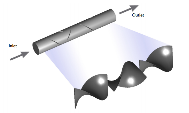

how to create a twist blade in comsol, like in comsol static mixer particle tutorial.
They haven't given the geometry details, how can i create this model with my own dimensions. I need to make the twist blade like in the figure, please help if anyone knows how to create it.

In the laminar static mixer model, the geometry of each blade is obtained by an extrusion with a 30 degree twist angle. See the mph file for the exact details.
More complex blade geometries can be created in other ways such as by lofting using the Design Module, see www.comsol.com/design-module and in particular this image cdn.comsol.com/products/design/impeller_collage_1024x835.png
