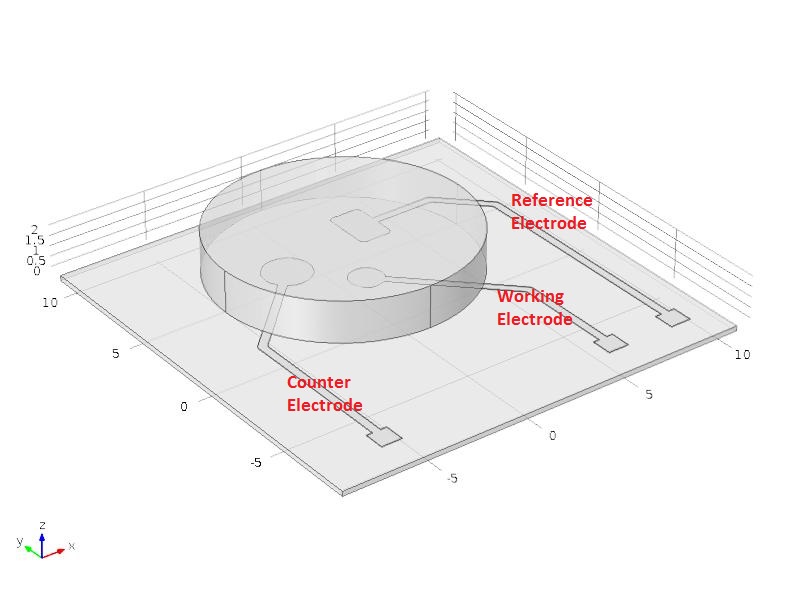

Hello, I am trying to simulate a sensor design for my research. My sensor consists of three electrodes which I would like to study the primary current distribution within the electrolyte. I have uploaded a .jpg identifying my three electrodes.

Is that a dilemma that you are applying primary current distribution also in the domain that has been defined isolated? Also, the reference electrode does not participate in the current conduction. I have not tried this but should it also be isolated?

You have primary current distribution also in the glass substrate and in the reference electrode.
