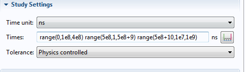

Yes, you can control the Times list for a time-dependent simulation to find a very short pulse by entering, for example,
range(0,1e8,4e8) range(5e8,1,5e8+9) range(5e8+10,1e7,1e9)
with ns (nanoseconds) as the time unit (see the attached screenshot, study_settings.png).
In the results part, the display resolution is 6 digits, so the time selection in a data set does not display the individual times very clearly when using such short time steps, but the COMSOL Multiphysics software uses 16-digit double precision floating-point values internally, and you can display the actual time steps using full precision by using a Global Evaluation node under Derived Values and evaluating the time t in a Table window where you click the Full Precision button (see the attached screenshot, full_precision.png).
As in other situations where you want to control the actual time steps taken by the solver, use manual time stepping by selecting Strict or Intermediate from the "Steps taken by solver" list.
Magnus Ringh, COMSOL
Hi, Yes, you can control the Times list for a time-dependent simulation to find a very short pulse by entering, for example, range(0,1e8,4e8) range(5e8,1,5e8+9) range(5e8+10,1e7,1e9) with ns (nanoseconds) as the time unit (see the attached screenshot, study_settings.png). In the results part, the display resolution is 6 digits, so the time selection in a data set does not display the individual times very clearly when using such short time steps, but the COMSOL Multiphysics software uses 16-digit double precision floating-point values internally, and you can display the actual time steps using full precision by using a Global Evaluation node under Derived Values and evaluating the time t in a Table window where you click the Full Precision button (see the attached screenshot, full_precision.png). As in other situations where you want to control the actual time steps taken by the solver, use manual time stepping by selecting Strict or Intermediate from the "Steps taken by solver" list. Best regards, Magnus Ringh, COMSOL

Hi Magnus Ringh
Thank you very much for your answer! This was very helpful!
Can you quickly explain what this means exactly:
I guess you cut it into 3 ranges:
The first from 0s to 0.4s with 0.1s steps.
The second from 0.5s to 0.000000009s with 1ns steps.
The third from 0.000000009s to 1s with 0.01s steps.
Is this interpretation right?

Hi Gabriel,
Yes, COMSOL Multiphysics interprets the list of output times as a concatenated list of (normally, monotonically increasing) times when entered as several expressions in the Times field, so your interpretation is correct, but there are perhaps a couple of typos. The total list of times to output from the simulation will be:
First from 0 s to 0.4 s with 0.1 s steps; then (with an implicit extra 0.1 s step)
from 0.5 s to 0.500000009 s with 1 ns steps; and finally (with an implicit extra 1 ns step)
from 0.500000010 s to 1 s with 0.01 s steps.
