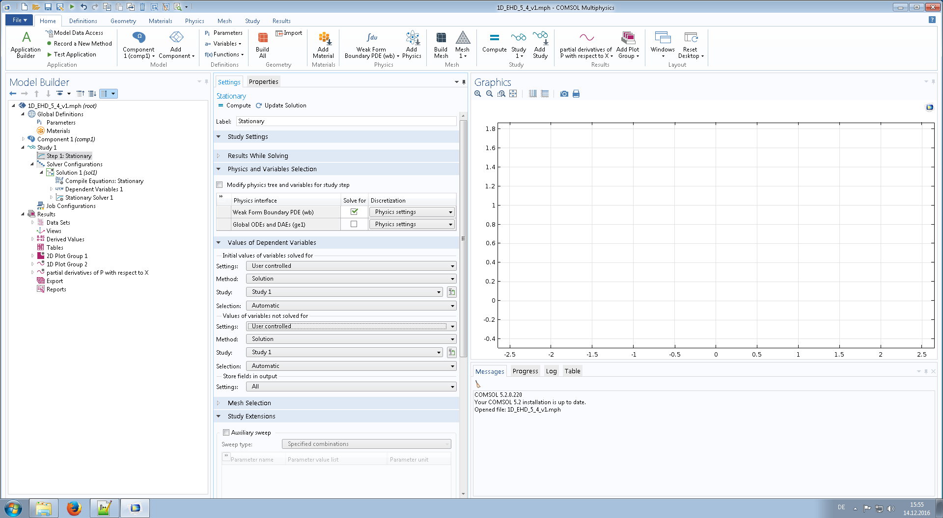

I also have a simulation which is controlled by MATLAB. And the solver also
needs to use his previously computed solution. I don't change the geometry within the
loop in MATLAB and the mesh also remains the same.
So I'm not sure if this solution can be used for your problem.
Because COMSOL has to map a solution from one geometry
to another, and also on a different mesh if have correctly understood you.
I would change settings in the Study - Step setup such that
the solver uses the previous solution as initial solution.
under "Values of Dependent Variables " ( see attached files)
- Initial values of variables solved for
- Values of variables not solved for
Hello, I also have a simulation which is controlled by MATLAB. And the solver also needs to use his previously computed solution. I don't change the geometry within the loop in MATLAB and the mesh also remains the same. So I'm not sure if this solution can be used for your problem. Because COMSOL has to map a solution from one geometry to another, and also on a different mesh if have correctly understood you. I would change settings in the Study - Step setup such that the solver uses the previous solution as initial solution. under "Values of Dependent Variables " ( see attached files) - Initial values of variables solved for - Values of variables not solved for

thank you for your reply. I know this funktion already but in my understanding this only works if you create several studies in one file that you run one at the time.
What i am lookink for is: I need to find a way to extract solution data from one simulated cycle and use those as initial value for the next cycle. this must be done through a matlab for loop and can't be done via several studies in Comsol itself.
Hallo Jurij, thank you for your reply. I know this funktion already but in my understanding this only works if you create several studies in one file that you run one at the time. What i am lookink for is: I need to find a way to extract solution data from one simulated cycle and use those as initial value for the next cycle. this must be done through a matlab for loop and can't be done via several studies in Comsol itself.
