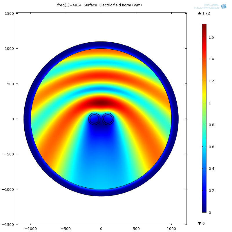

first (but it's probably not your true issue) how do you expect your field lines to be square or round (at infinity) ?
It's often easier (also for COMSOL) to use a round infinite element/ PML region and declare it cylindrical /spherical, and next, as IMPORTANT to place the origine at the centre of the figure. Because when you get it to converge, you will see modes patterns that I do not expect are truely physical for an infinite space
Then if I take your model in my 4.1, and reset it delete the solver and rerun it it works OK, for me the conclusion is find out with your rep how to update to v4.1 and apply latest patch.
Then I defined a Parameter
lamb=c_cont/4E14[Hz]
whcih is the wavelength, and I defined a variable
MeshPerLambda = lambda/h
and made a plot of my new variable. there I see that the mesh density is at least 27 elements per wavelength, which is fine enough with a good security factor, as you should have, in my view, at least 5 elements per wavelength perdiode.
Hi first (but it's probably not your true issue) how do you expect your field lines to be square or round (at infinity) ? It's often easier (also for COMSOL) to use a round infinite element/ PML region and declare it cylindrical /spherical, and next, as IMPORTANT to place the origine at the centre of the figure. Because when you get it to converge, you will see modes patterns that I do not expect are truely physical for an infinite space Then if I take your model in my 4.1, and reset it delete the solver and rerun it it works OK, for me the conclusion is find out with your rep how to update to v4.1 and apply latest patch. Then I defined a Parameter lamb=c_cont/4E14[Hz] whcih is the wavelength, and I defined a variable MeshPerLambda = lambda/h and made a plot of my new variable. there I see that the mesh density is at least 27 elements per wavelength, which is fine enough with a good security factor, as you should have, in my view, at least 5 elements per wavelength perdiode. -- Good luck Ivar
