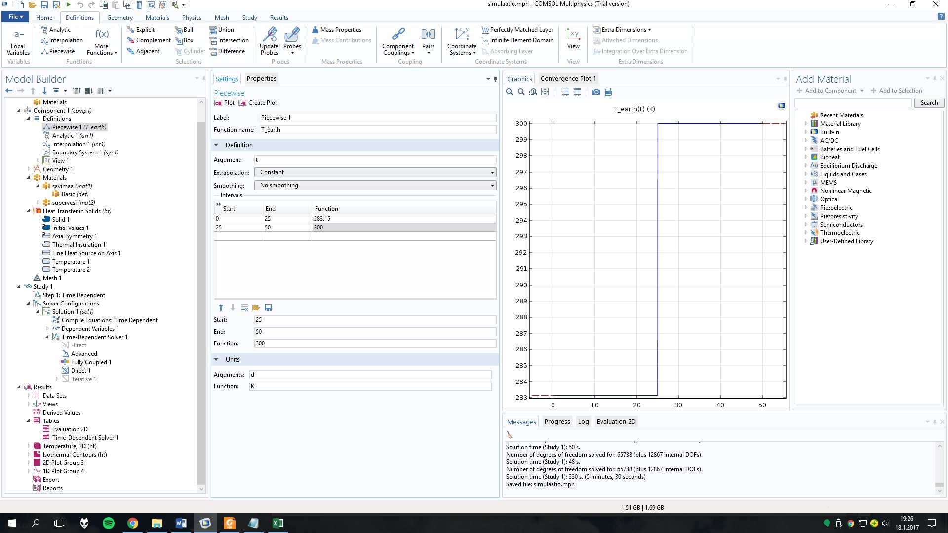

Hi. I am new to comsol and came across a weird problem that I need help with.

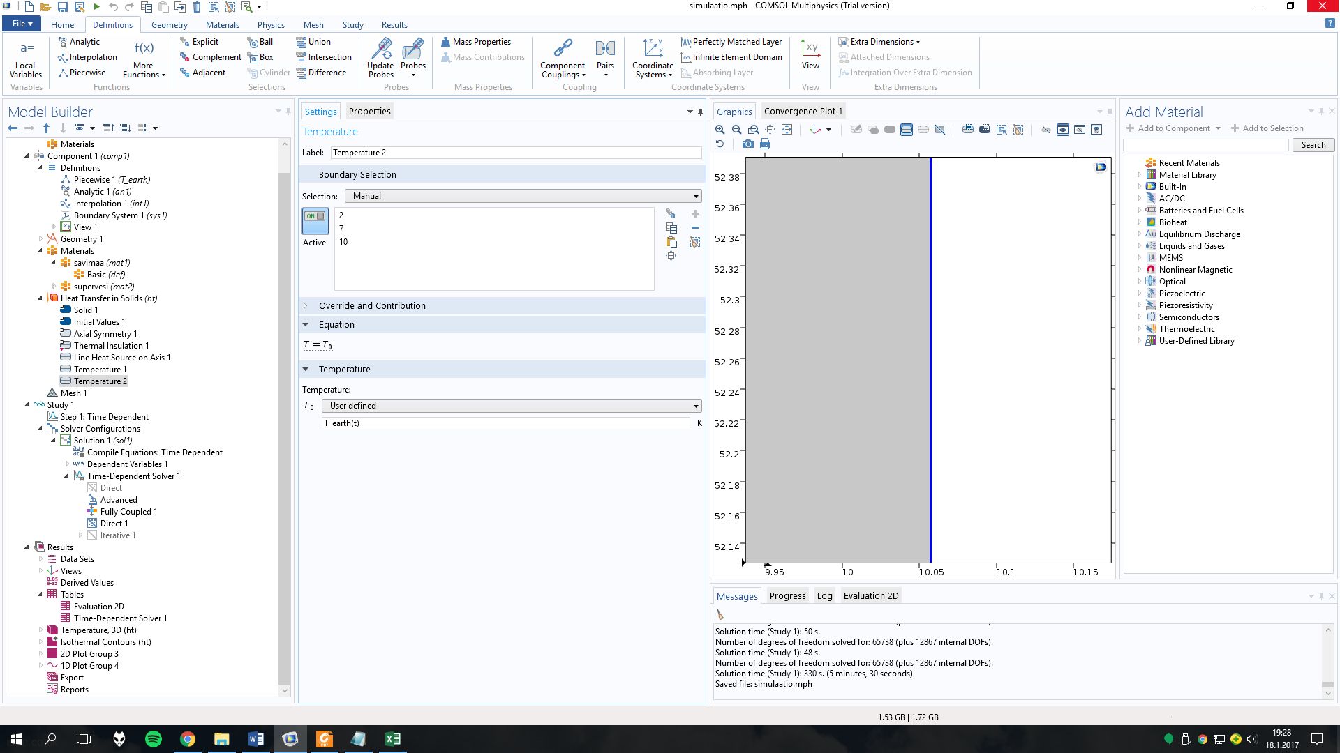

I use a piecewise function to determine a changing boundary temperature in my model like this:
Days 0 to 25: T = 283 K
Days 25 to 50: T = 300 K
Timestep = 0.1 day
So the temperature should change at day 25 but for some reason it changes prematurely at day 21! The magnitude of the deviance changes depending on amount of days simulated.
I have tried every trick I can think of to find the source of this problem but to no avail. The interpolation function gives same wrong outputs but the analytic function seems to work like it should.
Any ideas what could be causing this?
3 Replies Last Post 18.01.2017, 21:43 MEZ

Atte,
are you using free time stepping? The solver then chooses own steps regardless of your settings. This may work for smoother profiles but not in your case. You may need to use strict time stepping to resolve the step.

That was it! Thank you very much!
So what I had to change was (in my model) in the model builder: Study 1 > Solver configurations > Solution 1 > Time-dependent solver 1 --> Time stepping: steps taken by solver = Strict.
That was it! Thank you very much! So what I had to change was (in my model) in the model builder: Study 1 > Solver configurations > Solution 1 > Time-dependent solver 1 --> Time stepping: steps taken by solver = Strict.
