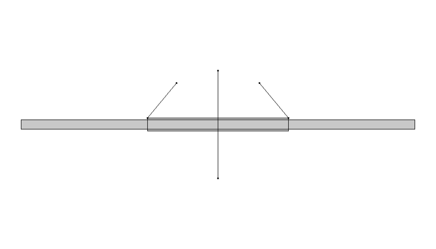

I try to make a diamond shape with curved corners.
1-How can I make a curve that goes through the three points? In addition, I would like that when the three lines are combined, it will form a continuous line.
2- I don't know if I complicate my life by doing this, if it does, your suggestions will be appreciated.
Thank you

Hello Vincent,
You can use an Interpolation Curve.
Hello Vincent, You can use an Interpolation Curve. Best regards, Jeff
