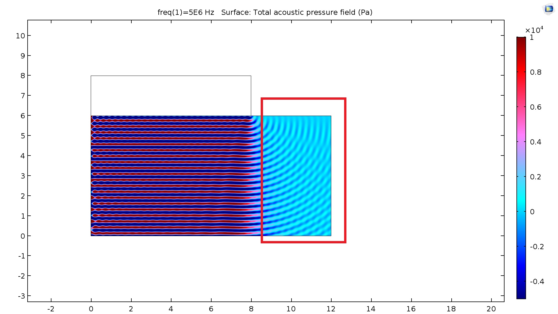

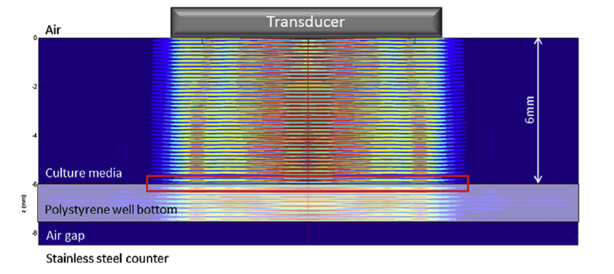

I am trying to reproduce a result from a paper (Please see figure 1).
The first thing that I tried was a model that include only transducer and water. As you can see in Figure 2, I got some waves that come out of transducer at an angle. I just want to have waves in the -z direction. How can I get rid of those angled waves?
Thanks,

You haven't said what boundary condition you have used at the bottom of your domain. I am guessing that it is an absorbing boundary condition. If so your figure (#2) shows the expected physical solution- namely, spreading of the ultrasonic wave at the transducer edge.
Figure #1 is different in the following ways: (1) smaller wavelength in relation to transducer size (2) mostly reflecting boundary condition at the bottom and possibly (3) insufficient resolution to really see what is happening at the edges.
If the published figure is a modeling result (and not, say, an artist's conception) then I would read carefully the details of the modeling performed and try to reproduce them as accurately as you can.

Thank you for your response. I got my answer based on your explanation.
My boundary condition on the bottom and right is "cylindrical wave radiation", so there should be no reflection at those boundaries.
