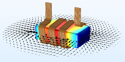

Additionally, how can I achieve a view where I see the coil turns that COMSOL generates like so: cdn.comsol.com/release/51/elec...rical/acdc/newCoilGeometry.png

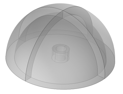

I've attempted to create a simplified geometry incorporating symmetry and IE domains. However, I ran
my 1/4 symmetry and a full symmetry case to ensure I am getting the same results for both cases, and found that the results are substantially different. I can't figure out where my problem lies. If you have an opportunity, it would be much appreciated if you would take a look at my 1/4 symmetry set up to see if I have made any obvious errors. I've attached the new geometry for both the full and 1/4 symmetry models.

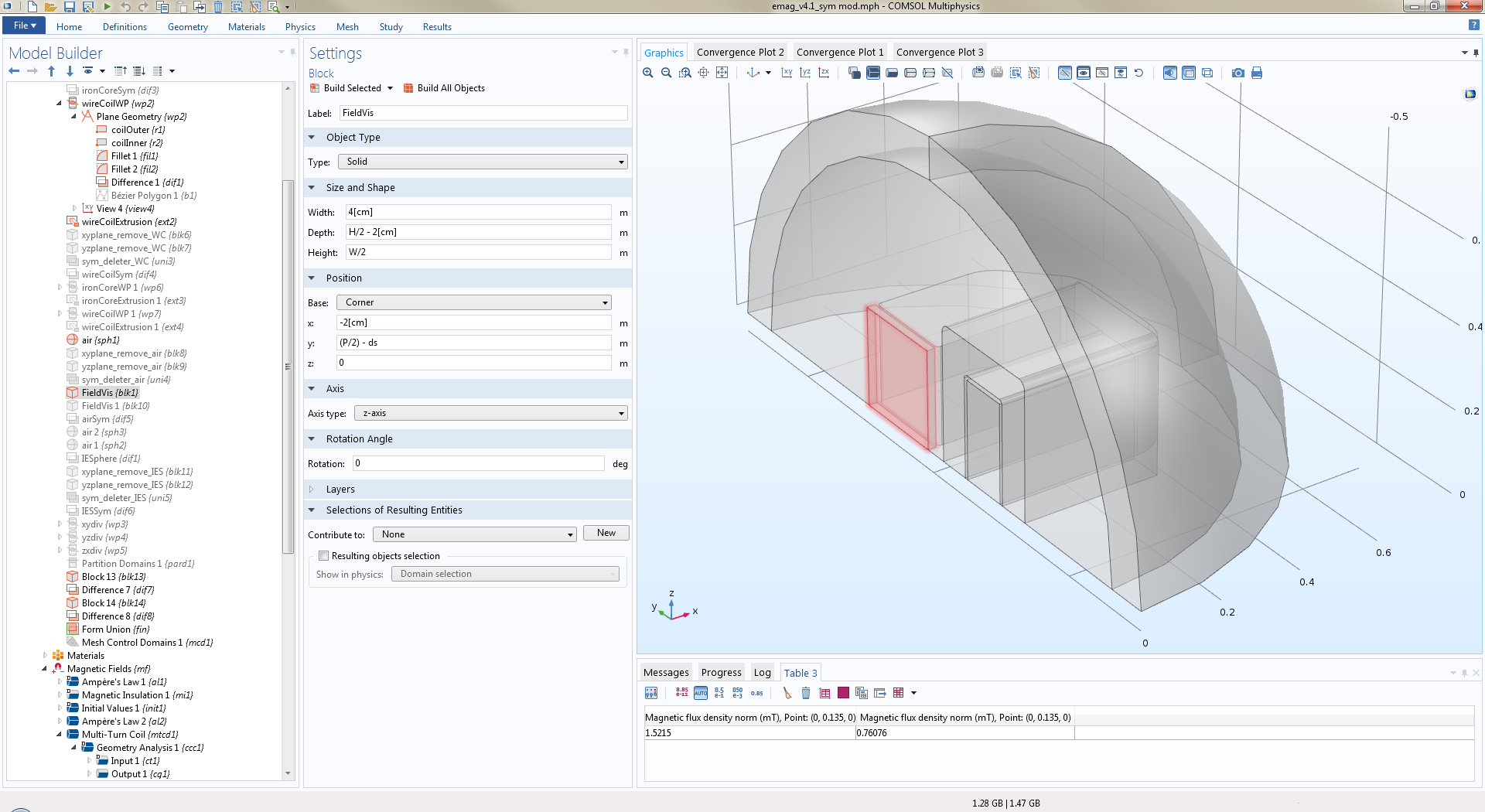

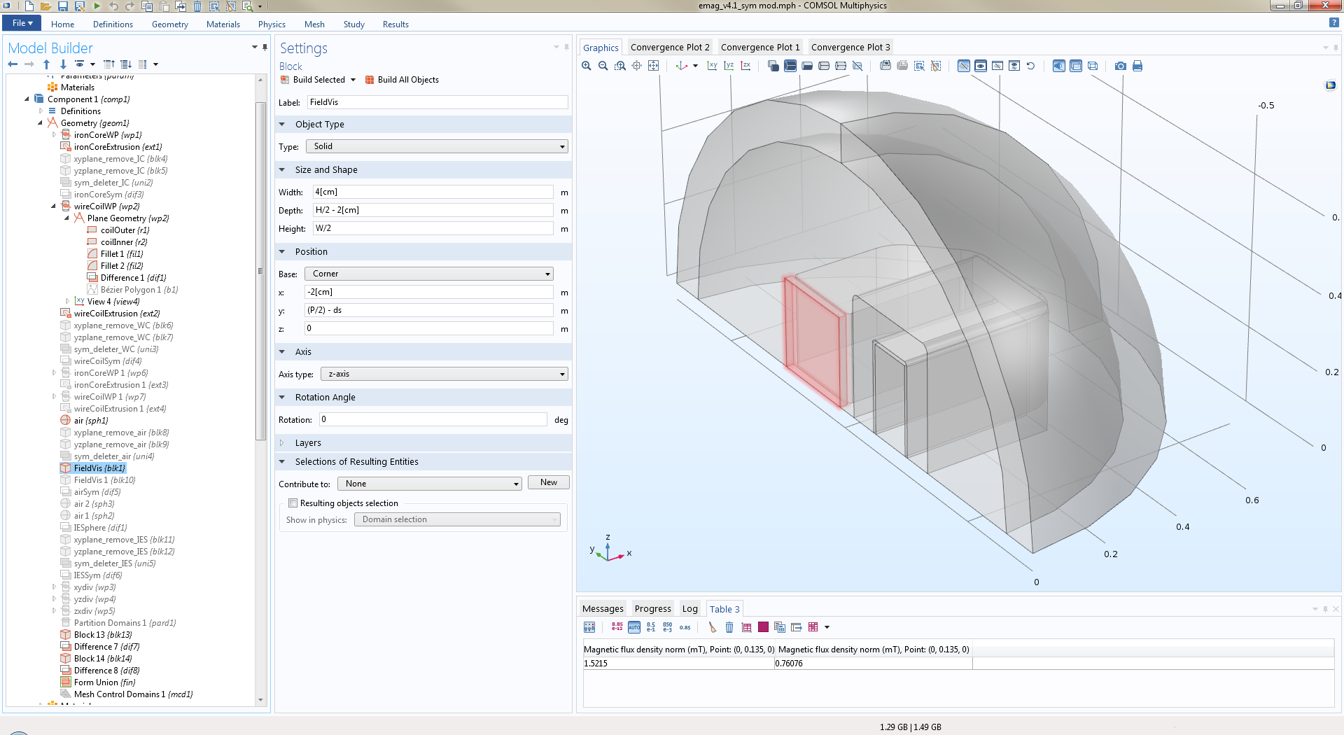

Your geometry sequence seems overcomplicated. I have run a 1/4 symmetry model where I have disabled a large number of your geometry nodes to simplify matters. Also, your mesh in the airgap was too coarse to reliably resolve accurate field values.
For the 1/4 symmetry model I modelled the system using your default current and obtain a field at the centre of the airgap of about 0.76 mT. For the full geometry, I obtained the same.
I think you were getting different results because you have not divided the current by 2 in the symmetric version, (only half of the turns are modelled). The symmetry condition closes the coil electrically, but in terms of the coils axial length, with the 1/4 symmetry, you only have 1/2 of the coil, so the total current should be stated as half of the "true" total current.

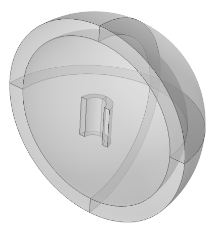

I have attached a screenshot of the simplified geometry sequence. The highlighted region is used as a mesh control domain, (I limited the mesh size in this mesh control domain to 0.01[m].
Rather than having all of those features (the ones I have disabled), just create the raw geometry, then use a couple of "block/Boolean difference" features at the end to split the entire model into 4, much cleaner.
To analyse results, I much prefer to use cut planes, cut points etc... as a change in those does not require the model to be re-meshed. You can just update the solution, much quicker.
Another thing that can help with these types of models (in terms of solution speed) is the option to use linear discretization. You can choose this, rather than the default quadratic discretization, in the settings for the main mf node. Test with both options, if no significant difference in result, you can use linear for much faster solution times.

edit: use the second attachment (better), the first image did not capture the entire sequence.

I created 3 different models (all attached), one of the full magnet (emag_V4.3_full.mph), one with half symmetry (emag_V4.3_hsym.mph, no PMC boundary) and one with quarter symmetry (emag_V4.3_qsym.mph). Maybe I'm just not using a fine enough discretization, but the results do not convince me that the symmetry scenarios (especially the quarter symmetry) are sufficiently equivalent and trustworthy.

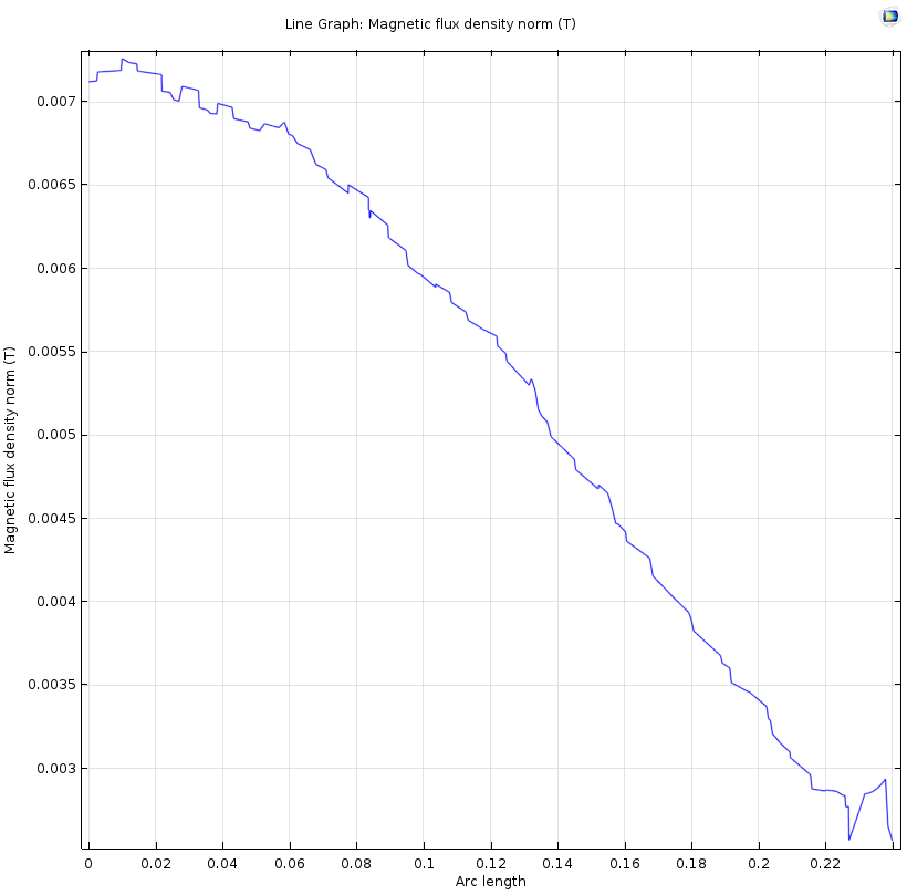

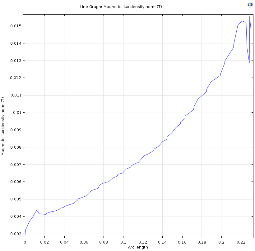

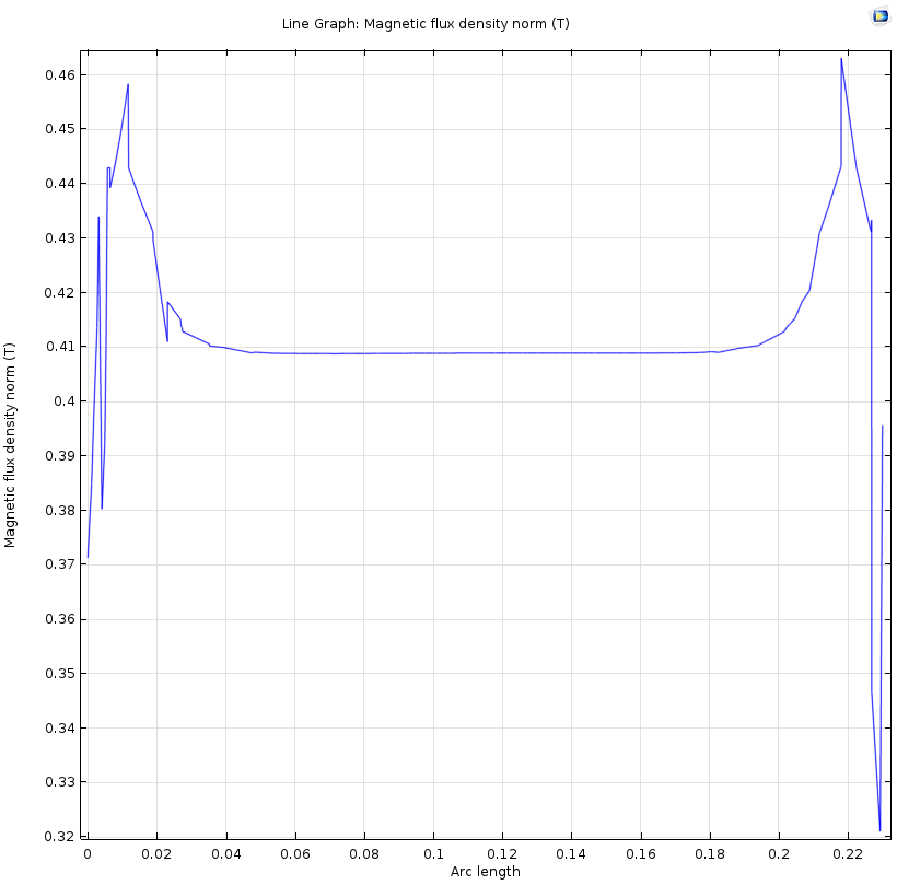

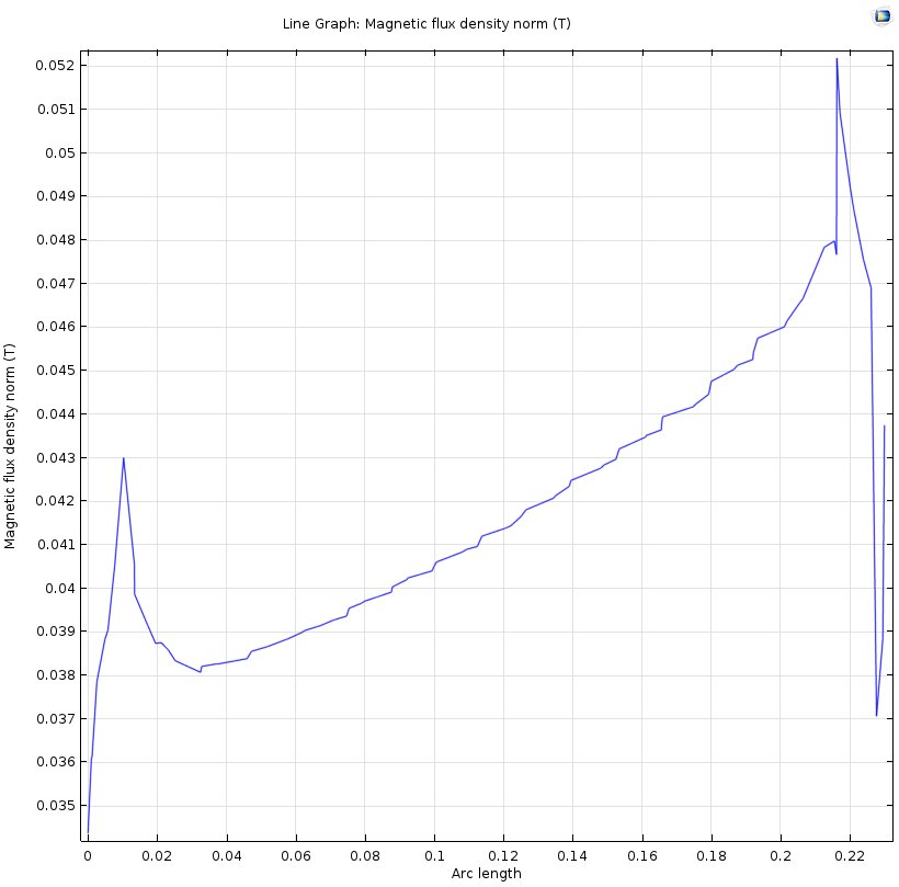

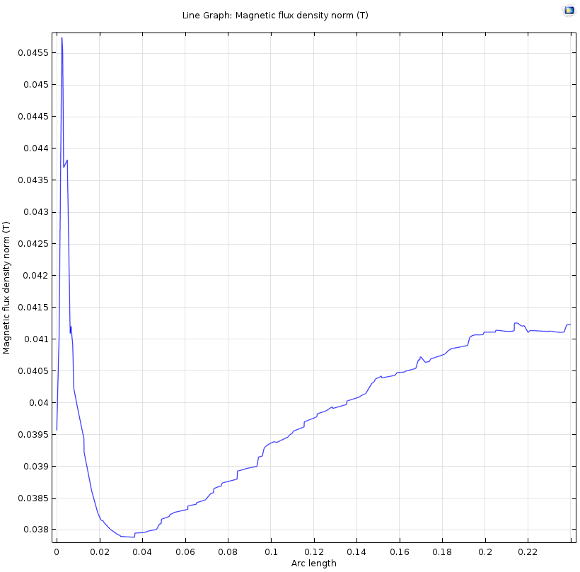

I've attached plots for 2 different cut lines in the gap (horizontal and vertical) for the 3 geometries, and while I feel the full and 1/2 symmetry are in reasonable agreement, the 1/4 is not. This is with respect to both amplitude of the field and the distribution/field pattern. If I was simply off by a factor of 2 in the current/# of turns, I would expect my magnitude to be off but the pattern to be relatively similar.

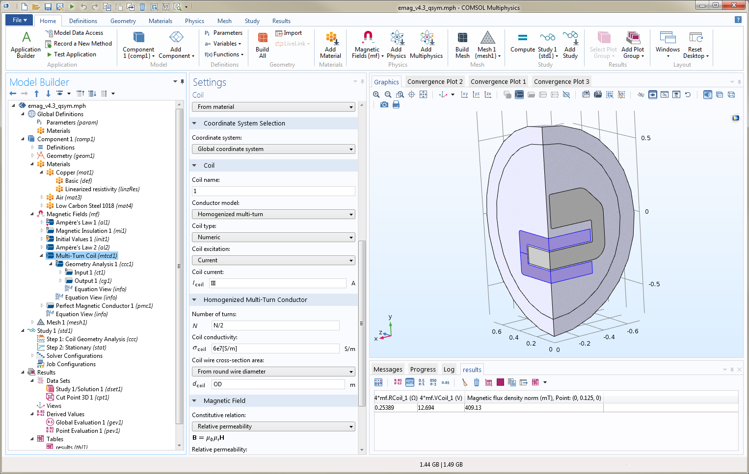

I meant to say to half the turns, not the current.
For reference, see the attached Excel file (zipped). In this I have modelled a simple coil with 1200 turns, a current of 2.262 Amps with a wire diameter of 0.5[mm].
Such a coil would have a resistance of about 10.4 Ohms, and would produce a field of about 57 mT at it's centre.
There are ways we can use symmetry to simulate this coil, we could cut the coil in half in 2 ways (refer to attached images).
The excel table shows the values that should be used in your model. Also, the Excel files shows what you should use as coil inputs.

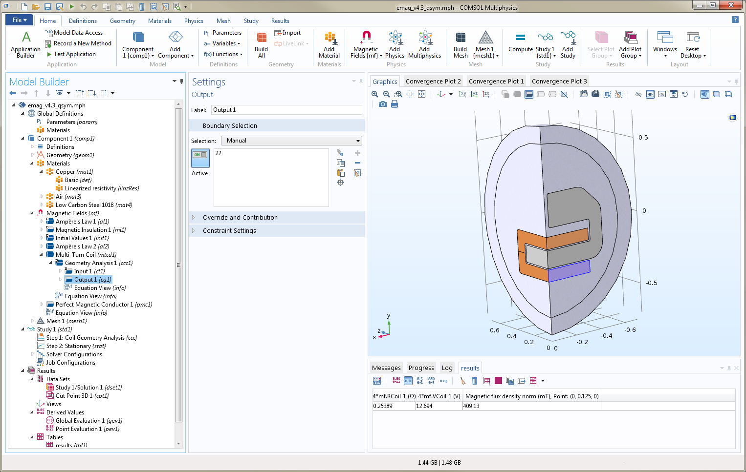

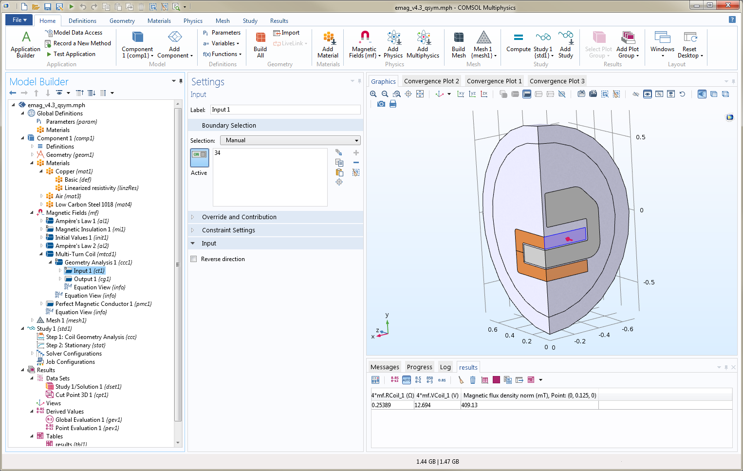

In your half model, you have not defined the coil input boundary correctly. When the coil is split for geometry reasons in this way, you need to define the coil input and output boundaries as the two "cut" boundaries of the coil in the model. Also, under the coil definition you should use N/2 as the number of turns.

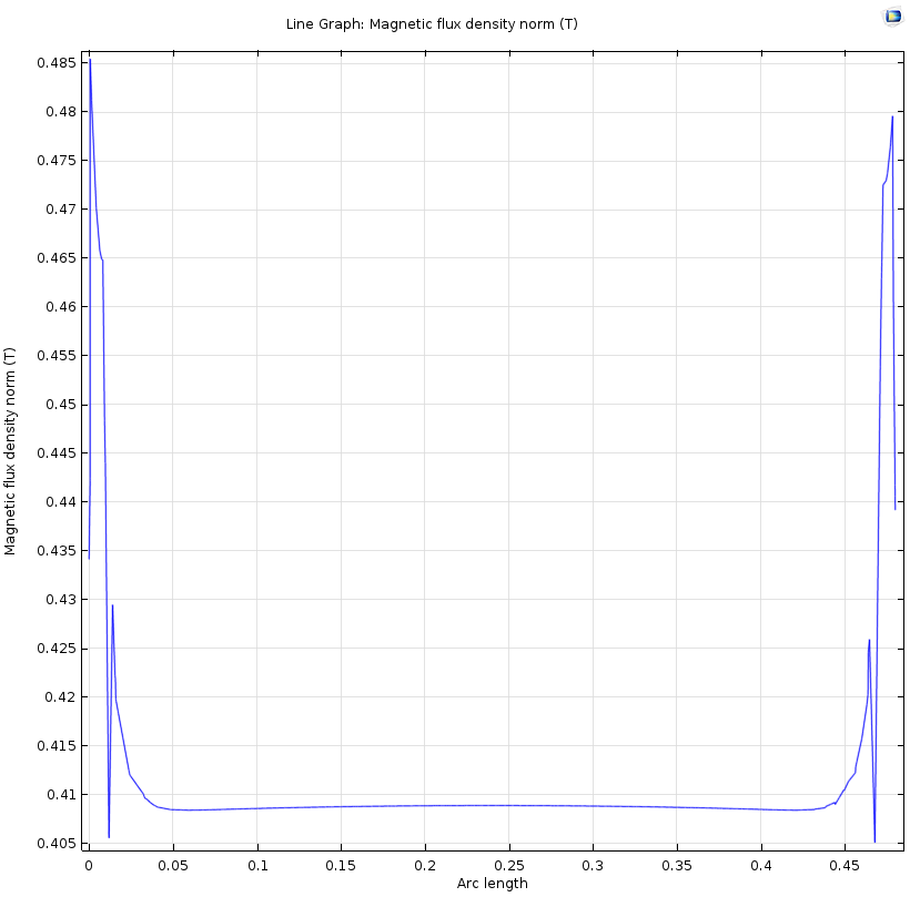

When these corrections are made, the field at the centre of your airgap is around 409 mT, rather than 8.5 mT as in your original model.
Your quarter symmetry model has no coil inputs defined. Adding those and again using N/2 as the number of turns gives a field at the airgap centre of 409 mT also (see attachments for reference).
You full geometry model gives a field at the centre of the airgap of 420 mT (although I did use linear discretization for the full model to speed up the solution). I would say these results are all equivalent.

Your line plots are based on cut lines in close proximity to the pole face edges. You will need a much finer mesh in these regions to accurately solve for the fields in these locations, (notice that your line plots are not very smooth).

The last question I have is this: how can I achieve a view where I see the coil turns that COMSOL generates like in the attached image?

Nevermind about the coil. I figured it out. For anyone else looking for it, it's a Streamline plot using Magnetic Fields > Coil Parameters > Coil Direction
