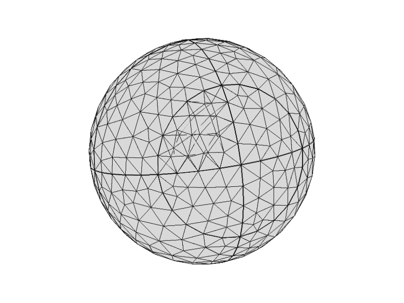

Posted: 1 decade ago 27.07.2012, 12:54 MESZ
It's so abnormal that the program gives such an error, since I have such 8 boundaries, but it gives an error about only one of them. Mesh looks like in the picture. It shows the problematic boundary.
how I created the geometry:
after creating two cylinders and one sphere, I intersected one cylinder one sphere with keeping input objects, so I created middle domains that are created by the intersection. Then I used delete entities to delete the remaining parts of the cylinder.
The result is one sphere with two caps at opposite ends.
physics undergrad
loves photon.
It's so abnormal that the program gives such an error, since I have such 8 boundaries, but it gives an error about only one of them. Mesh looks like in the picture. It shows the problematic boundary. how I created the geometry: after creating two cylinders and one sphere, I intersected one cylinder one sphere with keeping input objects, so I created middle domains that are created by the intersection. Then I used delete entities to delete the remaining parts of the cylinder. The result is one sphere with two caps at opposite ends. -- physics undergrad loves photon.
Posted: 1 decade ago 05.09.2012, 14:16 MESZ
when such an mesh related error occurs increasing the mesh quality from normal to fine or finer often helps but also increases calculation time a lot... in the ideal case you would only increase the quality in the problematic area - if u can find it
Posted: 1 decade ago 05.09.2012, 22:14 MESZ
my experience is that you should then identify where the mesh issue is and adapt the mesh manually to start to make some local entities with a finer mesh and leave the global "normal" mesh to avoid that you increase the mesh density everywhere.
But mesh density is your discretisation, so once you have solved, you shoul always check the gradients of your solutions, do you have several elements across anny steep gradient ? if not here you shoul densify locally your mesh
Hi my experience is that you should then identify where the mesh issue is and adapt the mesh manually to start to make some local entities with a finer mesh and leave the global "normal" mesh to avoid that you increase the mesh density everywhere. But mesh density is your discretisation, so once you have solved, you shoul always check the gradients of your solutions, do you have several elements across anny steep gradient ? if not here you shoul densify locally your mesh -- Good luck Ivar

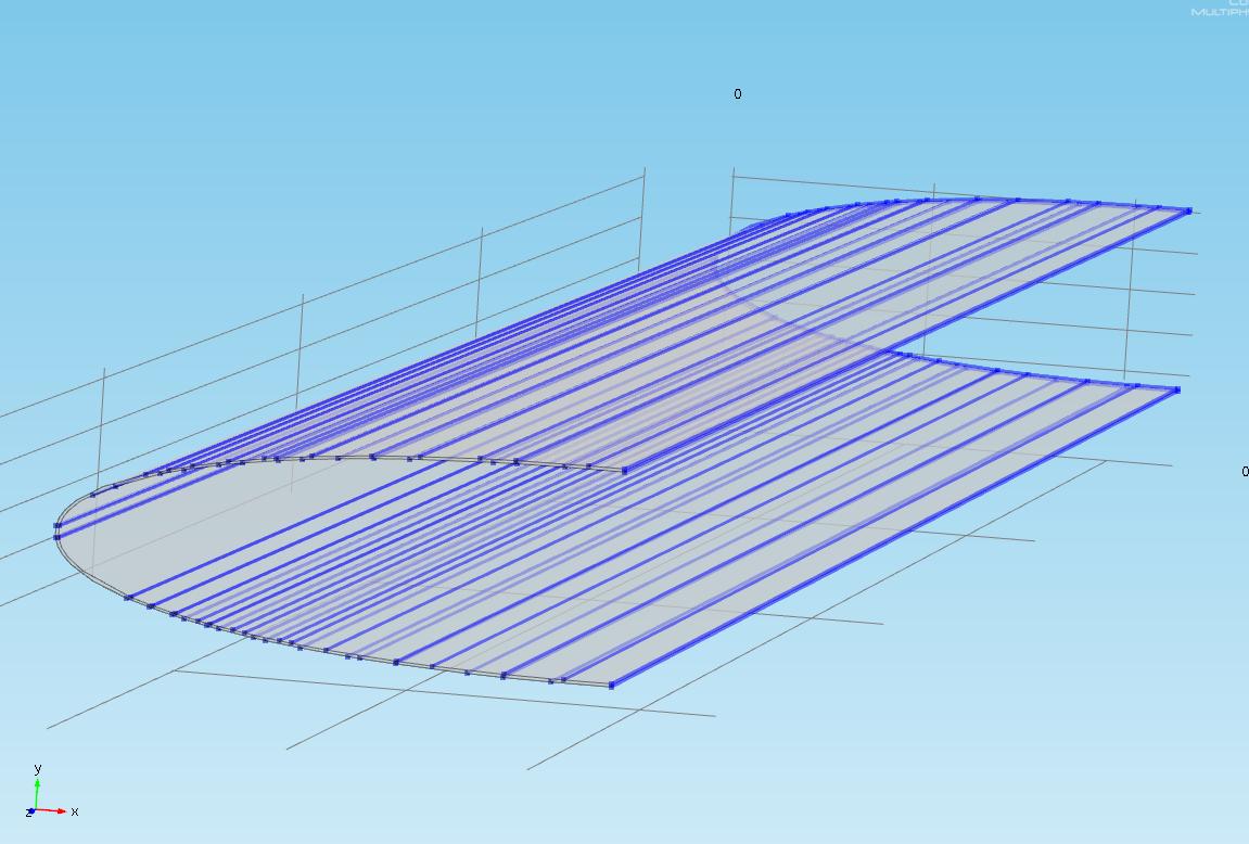

Posted: 1 decade ago 12.06.2014, 22:31 MESZ
Hello
I am trying to mesh the geometry as shown in the attachment. It has a thickness of about 0.05inches.
I tried to mesh using most of the mesh options available in 4.3a version, but still the error persists.
May I please know how to work on the problem?
Hello I am trying to mesh the geometry as shown in the attachment. It has a thickness of about 0.05inches. I tried to mesh using most of the mesh options available in 4.3a version, but still the error persists. May I please know how to work on the problem?
Posted: 1 decade ago 11.03.2015, 17:30 MEZ
I am aware this reply is late but if anyone else comes to this thread for advice on meshing,
I would have used a free triangular mesh on the arc then swept through the rest of the domain with a distribution and finally used a converted to change the squares created by the swept mesh into triangles.
Andy
