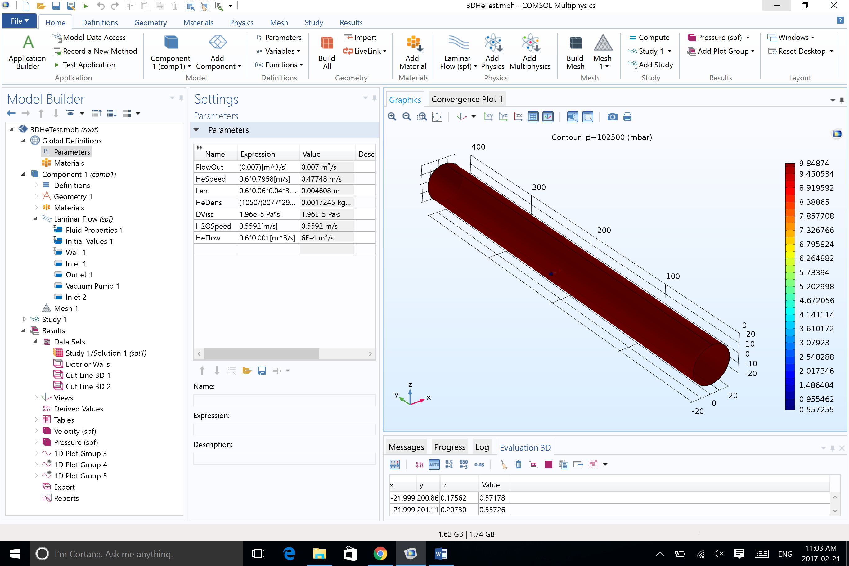

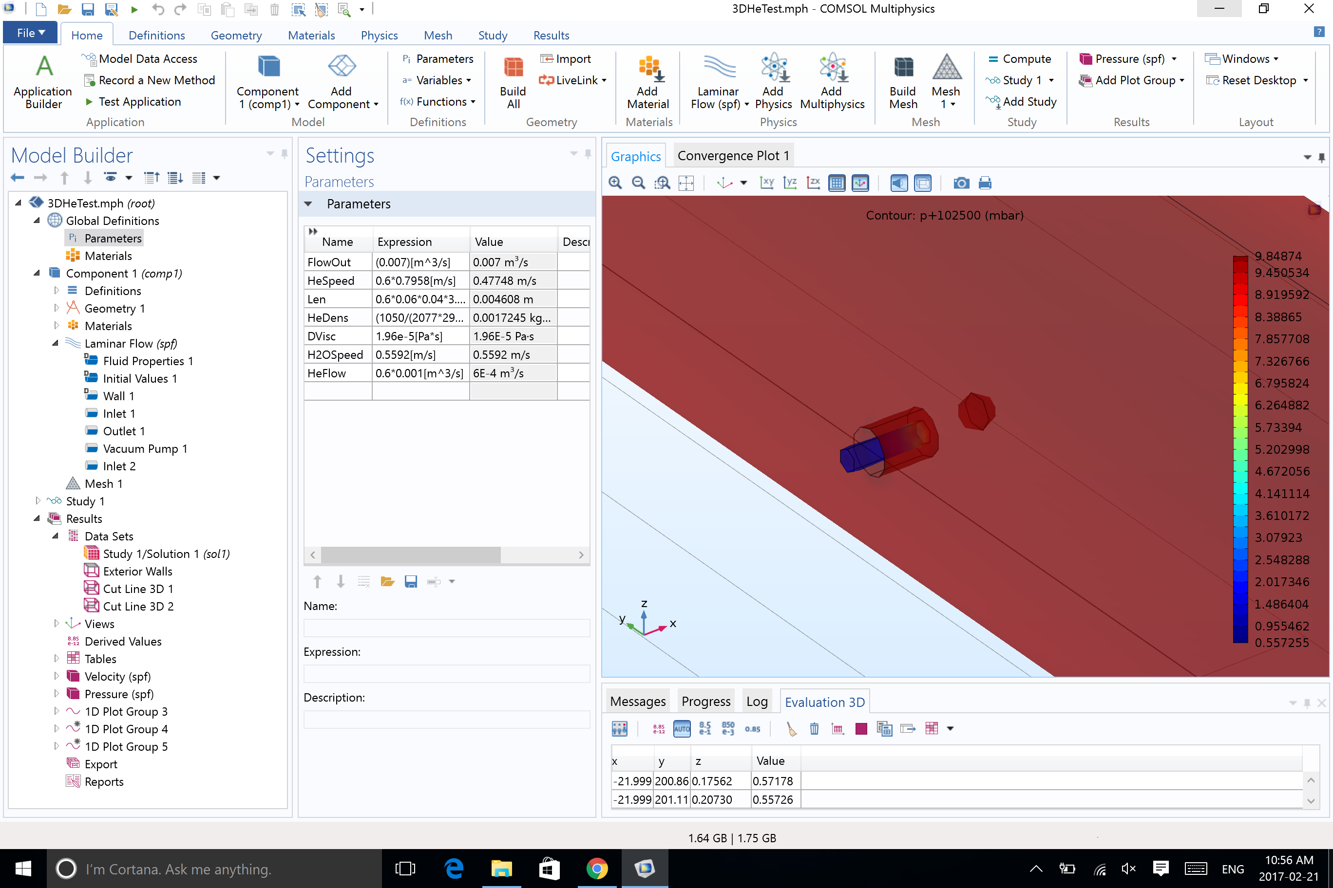

I forgot to add some pictures so I have attached them to this post.
