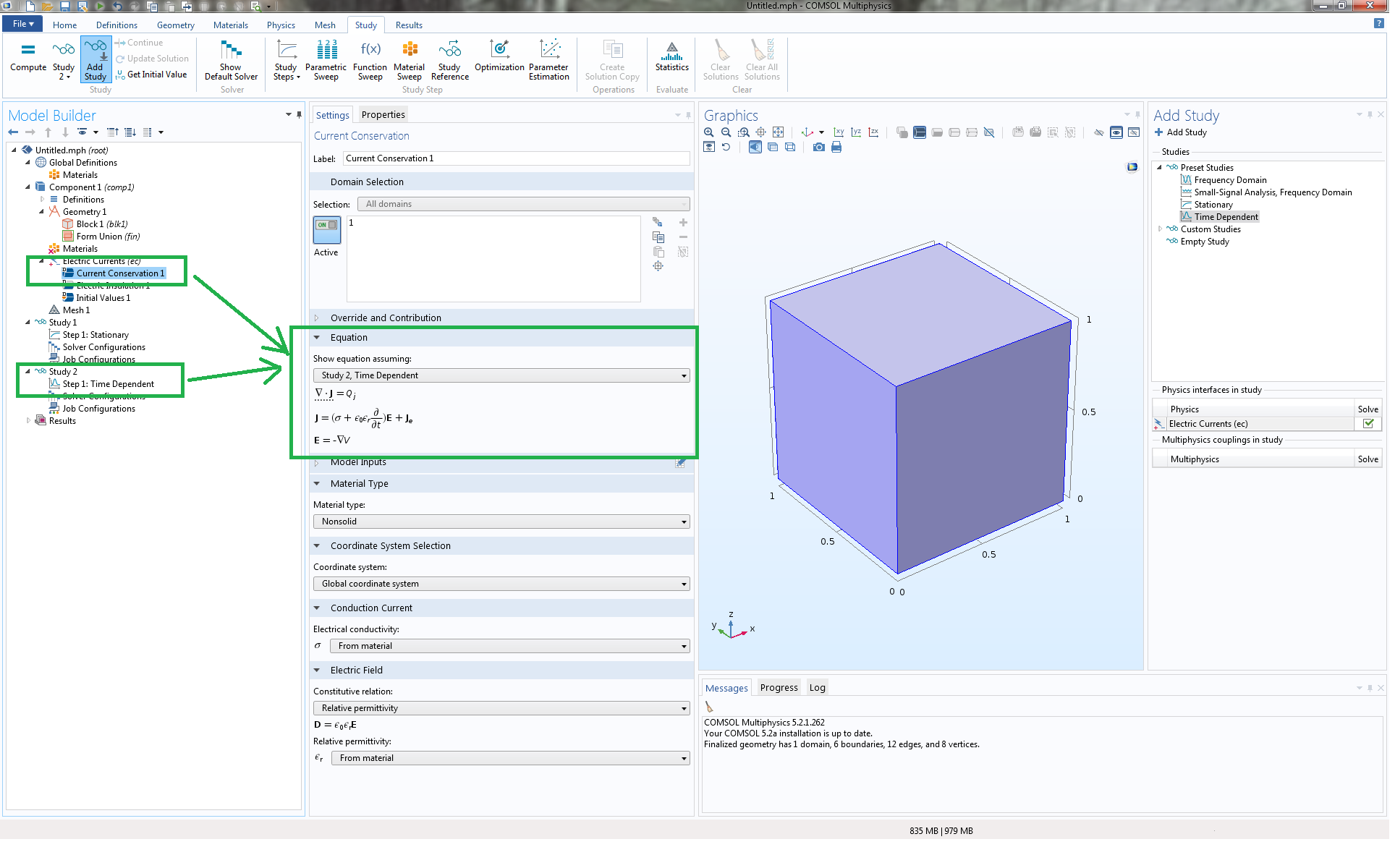

Posted: 9 years ago 28.02.2017, 08:23 GMT-5
Hello Carmen,
As long as you plan on solving the Electric Currents in a stationary way, only the conductivity is needed. The relative permittivity is needed when you do a time-dependent study, see attached screenshot.
Hello Carmen, As long as you plan on solving the Electric Currents in a stationary way, only the conductivity is needed. The relative permittivity is needed when you do a time-dependent study, see attached screenshot. Best, Jeff
