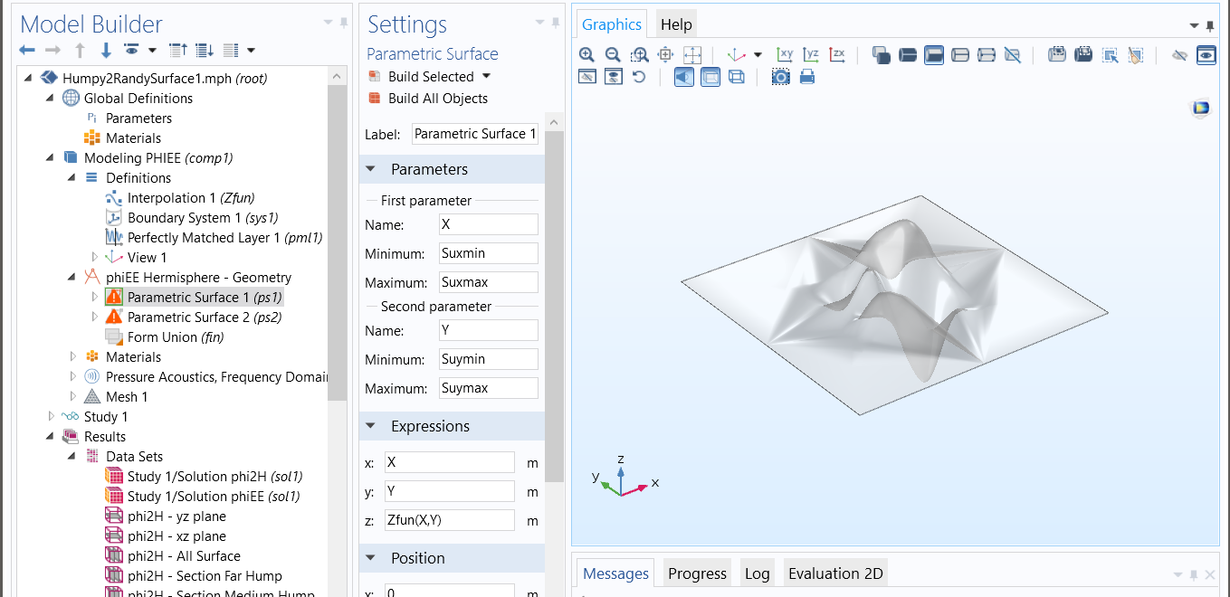

I have a unique 3D random (random points) surface generated. Am trying to import this data points into Comsol. This convert the points into a surface and then into a solid by extruding the surface. Thank you.

If I understand what you want to do correctly, you could use an Interpolation function and a Parametric Surface based on that function. What I have in mind is similar to www.comsol.com/support/knowledgebase/838/
but you'd be using an Interpolation function where the example above uses an Elevation (DEM) function.

Posted: 9 years ago 08.03.2017, 17:06 GMT-5
Hello Jeff,
Thank you. It did work but the shape of the surface is not exact.

Posted: 9 years ago 08.03.2017, 17:48 GMT-5
Hello Jeff,
Okay. I will do that. Find attached what Am talking about..
Actual Surface: is the actual figure
Surface after using the Parametric Surface: This is what I see after using the Parametric Surface.
Hello Jeff, Okay. I will do that. Find attached what Am talking about.. Actual Surface: is the actual figure Surface after using the Parametric Surface: This is what I see after using the Parametric Surface.

Hi Daniel,
Have you tried increasing the number of knots that are used to make the parametric surface?

Posted: 9 years ago 09.03.2017, 14:20 GMT-5
I did try to increase the number of knots. However, It's still the same.
