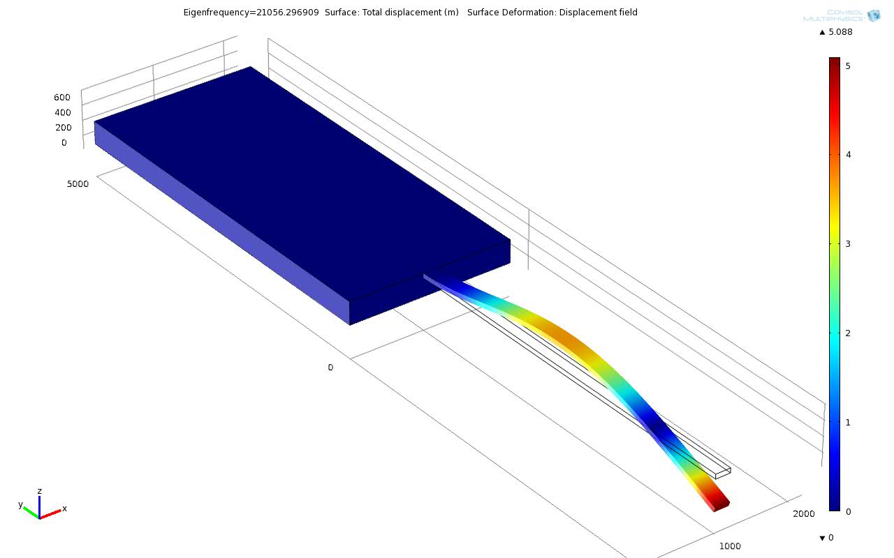

I have simulated a cantilever and done eigenfrequency analysis. I created a cantilever with the dimension in micrometer unit (l=1500um ; w=30um ; t=25um). I had then some 10 eigenfrequencies which are having different types, such as out-of-plane, in-plane, and torsional. But I am still having some questions:
1. Why do I get such a big displacement in here? It has reached around 6.19m. However, I define the geometry of cantilever in micrometers. It seems impossible to have displacement up to meter in unit. Anyone knows what really happen inside?

you shuld check the Forum (search) there are many questions around this. The main reasn is that an eigenfrequency is NORMALISED to an arbitrary value, COMSOL has selelcted one norm, other tools have other norms. In 4.1 you can now also select different norms (see the eigenvalue solver sub-node) including selecting the mass partcipation value, i.e. each eignfrequency is scaled w.r.t. its mass participation w.r.t. the three depedent varibles u,v,w.
An eigenfrequency analysis has no normalised energy input so normally all modes are shown with large displaceemnts even if this does not make really any sens i.e. u=6m for a 10um large part ;)

Yes, I have read some other threads about this issue, but there were not clear enough How big is the normalization?? Lets say I have 7m of displacement. May I assume that the real displacement of my cantilever is times of 10e-7 or 10e-6..So that my real value of displacement is around 0.7 um or 7 um (I saw it on another thread/forum)..I thought it is more realistic..:)..But I am not quite sure...It still does not make sense for me to see 6m displacement for 10um geometry. Since I want to know what is the smallest dimension of cantilever that I can create for my purpose, but without sacrificing the detectable deflection/displacement. If I just make 'assumption', then my results are BIG QUESTIONS..:). Please see the attached file..
And I was thinking that COMSOL cannot say the real value of displacement by eigenfreq analysis, since I have read one of paper from COMSOL conference about modelling Cantilever. And there are only the pictures of deformations of the cantilever in the first and second mode of resonant freq...And of course the value of 5 different modes of frequencies..That research group was comparing the theoretical value of resonant frequency with FEM and measurement. However, I did not see the legends/values which tell the reader how big is the deflection/displacement.
So, if I would like to get the real value of displacement..Do u have any suggestion what should I do?Should I use other solver? However, I am much more interested when my cantilever is working on high mode resonant frequency..

I believe you should first make clear for yourself the physics involved here, which parameters are involved, and how things are related.
From the eigenfrequency analysis you get ONLY frequencies out (as absolute values). Eigenfrequencies are properties of the material and the geometry only. The amplitude of the oscillation is a dynamic issue related to energy conservation and momentum transfer, which is fully different. To get amplitudes out you must know the forces in and the previous time variations involved, or with some PSD estimate of a input energy distribution versus frequency
The "mass participation factor" normalisation of the eigenfrequencies, allows you to tell the ratio of the energy that the different modes would have, if excited by a flat-energy random excitation, but only relative to each others, and for the three different directions. This i generaly of interest for engineers, as we then can identify the modes having the highest potential impact.
