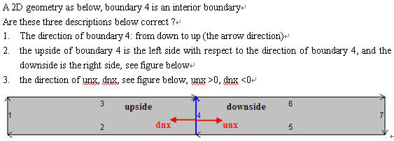

To make it clear, I believe (without being 100% sure) that you are right.
But I can state that the direction, in particular of interiours boundaries, is not unique, it all depends on how you build your geometry. The best is to check with the new arrow direction plots of un and dn.
In assembly mode it's easier, as then you have the domain and you can point, on a boundary, outwards (up) and inwards w.r.t the domain. and the boundaries are dedoubled between the assembled domains. Which means that you have two sets of "up / down", that are mostly opposed.
Now I seldom need to us the up/down normals, and can 99% of the time rely on COMSOL to look after this, and that is done without problems
Thank you, Ivar
You said "The best is to check with the new arrow direction plots of un and dn", how to plot? My way is Right click Results --- 2D Plot Group, choose Arrow Surface, but I cannot find "un" or "dn" in the Repalce expression.
Thank you!

                                Ivar KJELBERG
                                                Posted:
                                1 decade ago
                                07.02.2011, 10:03 GMT-5
I do not have access to COMSOL just now, but I believe the normal vectors are not in the physics submenu but the coordinates ones, the names are slighly more complex than just "dn", my shortcut for "downwards normal"

                                                    For those searching about up/down direction, the definitive part in the documentation is the Tangent and normal variables section in Comsol Reference Manual.
In 2D, go to Definitions > View 1 > Show edge direction arrows, then the up side is to the left of the boundary if the direction is taken as forward. Normals are usually outward normals everywhere.
                            For those searching about up/down direction, the definitive part in the documentation is the [b]Tangent and normal variables[/b] section in Comsol Reference Manual.
In 2D, go to [i]Definitions > View 1 > Show edge direction arrows[/i], then the [i]up[/i] side is to the left of the boundary if the direction is taken as forward. Normals are usually outward normals everywhere.
