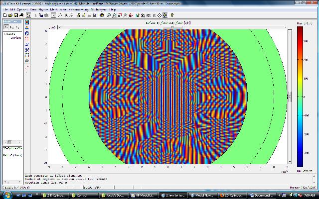

Thank you both for the comments. I think before I can start calculating my cross section I need to sure up my model. I am not getting the results that I should be, so I have been searching for the solution.
What I am trying to do first in 2-D (cylinder/circle) and will eventually move to 3-D like Yevgeniy's model. This should be easy I would think in 2-D, but I am missing something.
Here is a breakdown of what I am doing maybe someone on here will see something obvious I am missing. I have actually attached a COMSOL report with the details as well. I have a 30nm Ag cylinder (circle in 2-D) that I am using a Drude model to model the material. I want to have a TM wave incident on the cylinder and measure the far field scattering cross section at a wavelength range from 300-700nm. I know there should be a peak in the Scr at ~340nm and know what the surface plot should look like. I am using RF Module/TM-waves /Harmonic Propagation right now. I tried using Scattered Harmonic Propagation with the same results.
I have a PML, an intermediate ring of just vacuum where I will measure Scr and the Ag cylinder. Just looking at one wave length say 340nm (where I expect my resonance), I get a very strange result. When I plot my surface of the incident Ey wave (Ey_rfweh-scEy_rfweh) my incident field looks very distorted. I think this be my first problem. I attached a screen capture.
Any input would be greatly appreciated. I know I probably haven’t provided enough information as there is a lot that goes into each model. Hopefully some has had similar issues when they first started and can suggest things to check from experience.

Here it is.
Maybe I am doing this all wrong? Once again, all I am trying to do is to measure the scattering cross section of a 30nm (radius) Ag cylinder. The model I uploaded is only evaluating at 340nm where I expect a resonance, which should be visible in a surface plot of Ey and also Hz. Once the model is correct I will sweep frequencies between 300 and 700nm. I hope to generate a Cscatter plot which looks like my attachment (done with analytical approach in Maple)
Any help would be greatly appreciated.
Here it is. Maybe I am doing this all wrong? Once again, all I am trying to do is to measure the scattering cross section of a 30nm (radius) Ag cylinder. The model I uploaded is only evaluating at 340nm where I expect a resonance, which should be visible in a surface plot of Ey and also Hz. Once the model is correct I will sweep frequencies between 300 and 700nm. I hope to generate a Cscatter plot which looks like my attachment (done with analytical approach in Maple) Any help would be greatly appreciated.

I never used 2D, so I'm not sure what is that you need to get from the simulation.
But for sure decrease subdomain size, make mesh more fine (34nm for outersubdomains and even less for cylinder). And try other modes. And try to get good results with complex index of refraction for Ag, and then continue to Drude model.
I never used 2D, so I'm not sure what is that you need to get from the simulation. But for sure decrease subdomain size, make mesh more fine (34nm for outersubdomains and even less for cylinder). And try other modes. And try to get good results with complex index of refraction for Ag, and then continue to Drude model.

Yevgeniy, thank you so much for your help. I ended up making adjustments based on your suggestions and it worked beautifully.
