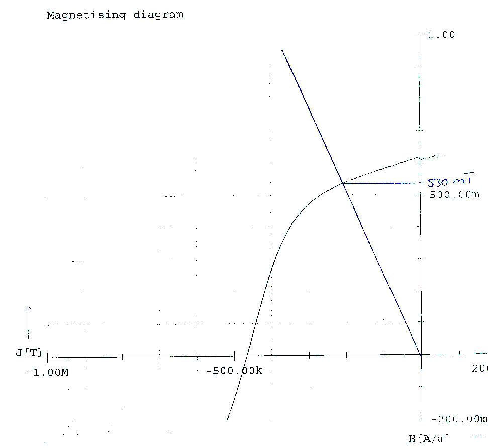

Dear Johan,
Where can I find some details about the "diagonal relative permeability tensor" that you have mentioned in your replies. Also I would like to know where to find out details of some functions that are used in COMSOL such as mf.Bx or mf. By etc. etc.
I wish to use two types of magnets in my design one has Br of 1.47 T and Hcj of 955kA/m and other has Br of 1.18 and Hcj of 2465 kA/m. How do you model these two magnets in the same model. I am working on design of halbach hexapole where i wish to use these to types. can you please suggest me the best way to go about this problem?
with Kind regards,
Nabhiraj
Dear Johan, Where can I find some details about the "diagonal relative permeability tensor" that you have mentioned in your replies. Also I would like to know where to find out details of some functions that are used in COMSOL such as mf.Bx or mf. By etc. etc. I wish to use two types of magnets in my design one has Br of 1.47 T and Hcj of 955kA/m and other has Br of 1.18 and Hcj of 2465 kA/m. How do you model these two magnets in the same model. I am working on design of halbach hexapole where i wish to use these to types. can you please suggest me the best way to go about this problem? with Kind regards, Nabhiraj
Posted: 1 decade ago 15.09.2015, 08:04 GMT-4
Hi Nabhiraj,
I did something similar for a quadrupoles.
First of all I use the mfnc module. I define two interpolation functions "Global definition -> functions -> interpolations"
As Data source I chose "table" and I put the BH curve data of the magnetic material, you can find the BH curve on the web if you don't have it.
Thick "define inverse function" and use linear interpolation and extrapolation.
Then I define a variable named modM = ((BofH(mfnc.normH)/(mu0_const))-mfnc.normH) which represents the magnetization module.
You need to define two of them, like modM2=((BofH2(mfnc.normH)/(mu0_const))-mfnc.normH) for the second material
Finally define a magnetic flux density law for each magnet and in the constitutive relation chose "magnetization" and give your variable to each block with the proper angle if you need.

Sorry, my reply get lost...
modM = ((BofH(mfnc.normH)/(mu0_const))-mfnc.normH) is the variable I define to make easier and it is the magnetization of the material.
BofH is the BHcurve interpolation function Mu0_const is the permeability and normH is the independent variable in Comsol.
You need to define 2 BHcurve named BofH_i (i=1,2 depending on the material)
Then you go on model->definitions->variables and define two modM varialbles:
modM_i = ((BofH_i(mfnc.normH)/(mu0_const))-mfnc.normH)
It is basically eq(8) at page 6 here: ocw.mit.edu/resources/res-6-001-electromagnetic-fields-and-energy-spring-2008/chapter-9/09.pdf
Then you use you modM1 or modM2 for the two material in the ocnstituve relations
