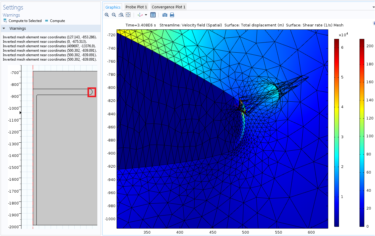

This is a 2-way FSI problem. I am using an axisymmetric domain (see image) and the automatic re-meshing technique mainly to improve the mesh of the fluid of the magma chamber, subjected to a strong expansion.
The analysis always stops due to inverted mesh elements (the inverted element are those along the fluid-solid interface), no matter if I improve the mesh with smaller elements at the interface or if I increase the time steps. I reduced the tolerance to 0.0001, but doesn´t help. I can control the quality of the mesh by using the mesh quality as condition for re-meshing. I set the threshold for the minimum mesh quality at 0.5, but it doesn´t help. The solution doesn´t converge (and I still get inverted mesh elements) even if the mesh doesn´t look bad at all.

Solid Mechanics does not lend itself well to automatic remeshing, which is why it is not recommended to use that with FSI.
However, the moving mesh feature with help lines for mesh deformation can be used rather successfully. See this blog post for more info:
www.comsol.eu/blogs/model-translational-motion-with-the-deformed-mesh-interfaces/
