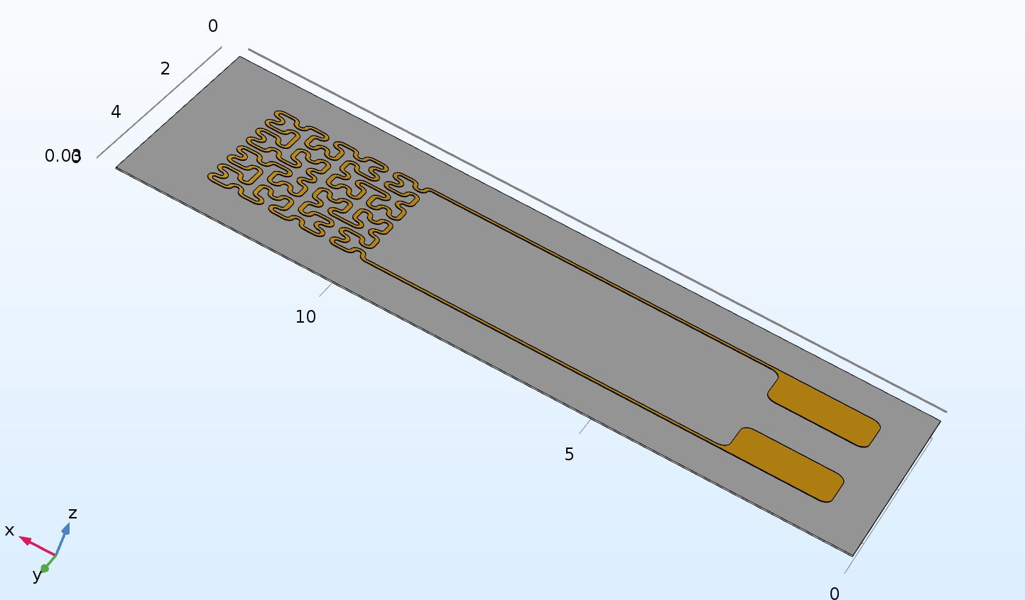

Dear Sergei,
Many thanks for your answer! I am trying to get a swept mesh to work for my 3D geometry. I'm having difficulties at the interface between the two layers due to the complexity of the geometry. I have managed to get a swept geometry for the resistance part on top. Do you know how I could get the mesh to work at the interface of the two? I'm attaching an image of my geometry.
Thank you very much,
Amanda

Posted: 8 years ago 08.05.2017, 20:17 MESZ
Amanda,
Attached is thin layer geometry with Swept mesh. You can control layer thickness using global parameter t_layer.
Are you sure that thin layer should be modeled as a solid domain? If the thickness of the layer is small then you can model it as a shell - look at the model example
www.comsol.com/model/heating-circuit-465
Sergei

Posted: 8 years ago 12.05.2017, 10:04 MESZ
Dear Sergei,
Thank you very much for the file with the example swept mesh, it was extremely helpful! I am now comparing a shell model with a swept model. I think the shell model might be better as you suggested.
Thank you!
Amanda
