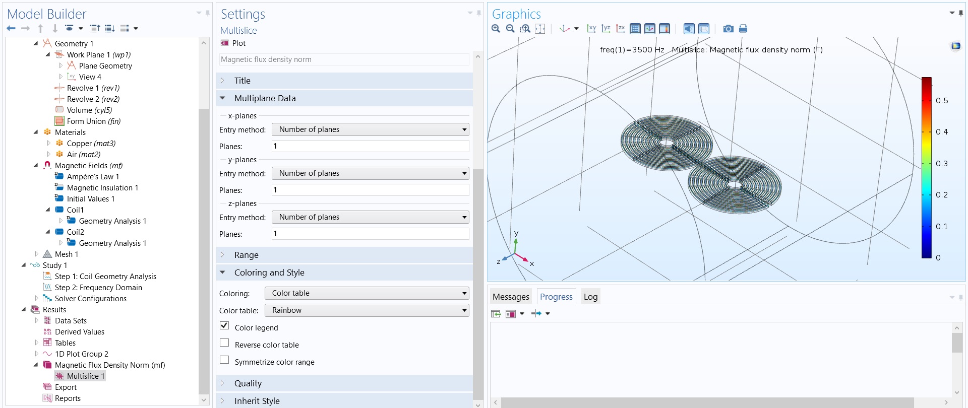

I'm working on a figure-8 coil model that is widely used in medical treatment for neural diseases.
I have successfully modeled the kind of coil I wanted and created a boundary volume around it.
I'm interested in simulating its magnetic field intensity in both 2D planes and in 3D volume.
I have a problem that the magnetic insulation boundary conditions apply themselves to the coil itself - not to the boundary volume as planned, causing the results to appear only inside the conductors. For the boundary volume it tells that magnetic insulation is "not applicable".
I have attached a screenshot of the compiled result I got.
Would anyone have any ideas what could cause this.
Thank you for the help!

Hi Pauli,
Don't give up so quickly!! As you surely know, COMSOL applies continuity to interior boundaries by default (if you finish your geometry with a Union, as you did; otherwise, you can set that condition manually).
Apart from that, the infinite elements are very useful to model the far fields, did you use them?
If you share your model, perhaps the rest of us can help you a bit.
