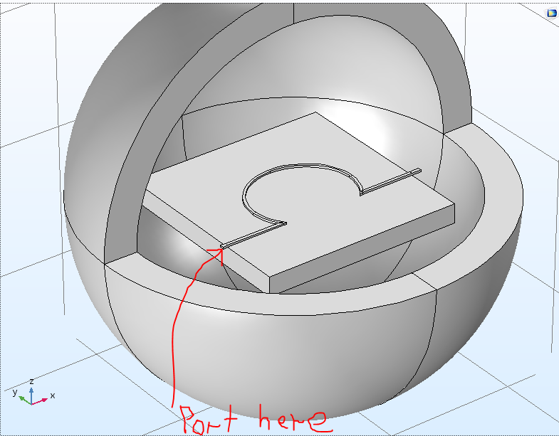

I have a very easy model of microstrip antena (prntscr of model is attached) that i d like testing but i failed on add microwave port on it. I try add Lumped port (in real we have omega shape anthena where is microwave added by coaxial, but i d like make it very easy - input power is 1W).
But there is error
Uniform lumped port should be placed between two conductive boundaries.
- Feature: Type: Lumped Port
Tag: lport1
Operation: LumpedPort (lport1
Can you help me please?
Thanks
