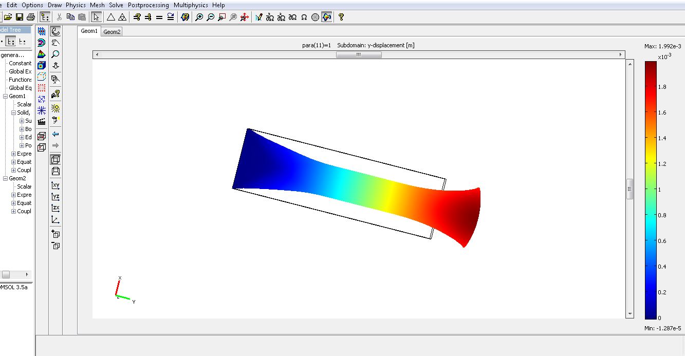

I'm trying to model the simple uniaxial tansion of a neo-hookean hyperelastic beam, and i have some problems about the bounday contrain.
I fixed an extremity and i impodes a ditribuited load at the othe end. The problem is this last end: infact i would like to constrain both ends of the strip, in a such way the loaded end can't deform in any direction.
I tried the roller and the axial simmetry constrain, and the prescribed displacement, but the problem remain.
In attach the fugure of the deformed shape of the beam. What can i do to prevent the deformation of the face in the load direction?
Thanks a lot for your help!
Sandra

if you want to impose that the loaded edge remains "straight", then you should look up the example in the 3.5a doc about a rigid edge beam, but I do not remember exactly in which doc it is ;)
Hi if you want to impose that the loaded edge remains "straight", then you should look up the example in the 3.5a doc about a rigid edge beam, but I do not remember exactly in which doc it is ;) -- Good luck Ivar

Thank you Ivar!
I found the example you suggest in Structural Mechanics Model User's Guide, and also I found this topic in the forum
www.comsol.com/community/forums/general/thread/7961/
But in my case, the domain to be "stright" is not an edge, but a face, and i work whit the Structural mechanics->solid stress-strain module, so i didn't understand how i can apply the edge example.
Sandra
Thank you Ivar! I found the example you suggest in Structural Mechanics Model User's Guide, and also I found this topic in the forum http://www.comsol.com/community/forums/general/thread/7961/ But in my case, the domain to be "stright" is not an edge, but a face, and i work whit the Structural mechanics->solid stress-strain module, so i didn't understand how i can apply the edge example. Sandra
Posted: 1 decade ago 20.02.2011, 13:52 MEZ
well if you are in true 3D then you boundaries are 2D, indeed you need to adapt the example from the 2D (1D boundaries=edges) to faces
By the way in 4.1 you have the RBC (rigid boundary conditions) that will do it for you
Hi well if you are in true 3D then you boundaries are 2D, indeed you need to adapt the example from the 2D (1D boundaries=edges) to faces By the way in 4.1 you have the RBC (rigid boundary conditions) that will do it for you -- Good luck Ivar
