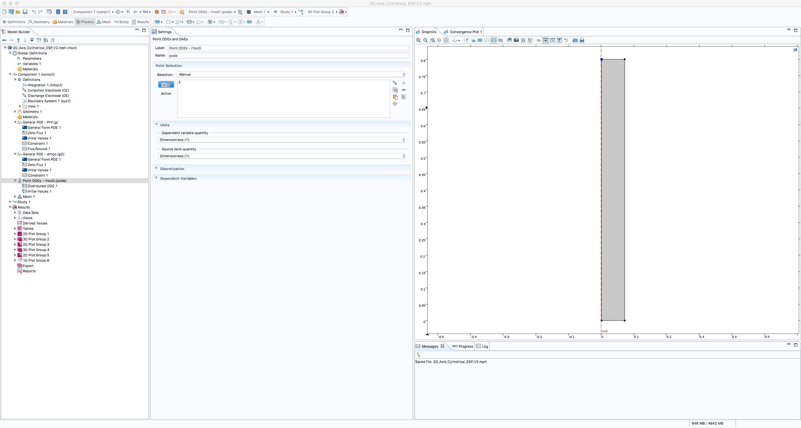

Thanks for the suggestion. I have the issue resolved. The electric potential at the collection electrode needs to be a Dirichlet BC to make it well-posed. The variable BC can be applied with the point ODE.
I have another question about the integral constrain using the point ODE. I am solving a 2D Axisymmetric ESP (see attachment). Instead of using a fixed point to constrain the electric potential to V0 at the discharge electrode, is it possible to move the point ODE along the z-axis during each iteration step to obtain a 2D distribution of the electric potential?
Thanks again.
