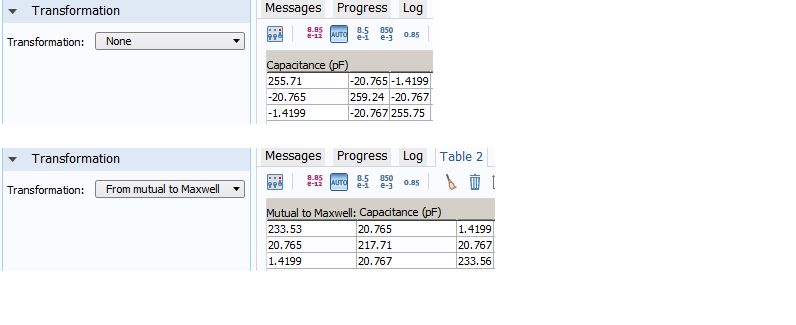

Sergei,
Sure , in your file, you have plotted the first one under Transformation: None
the second one is under Transformation: Maxwell to mutual
Please try the following option under Transformation : mutual to Maxwell, you will get exactly the same answer for, may be that is an error or something I guess.
Transformation: Maxwell to mutual and mutual to Maxwell.
