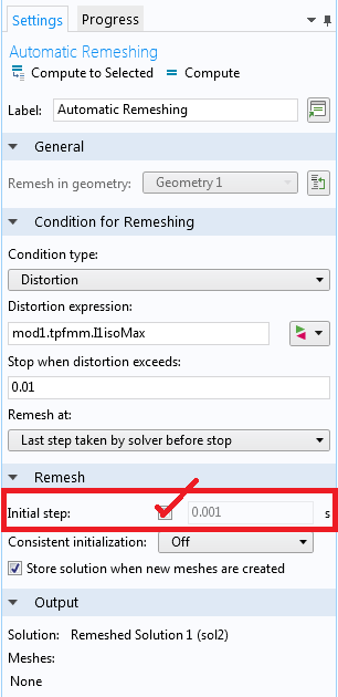

Posted: 8 years ago 10.06.2017, 03:27 MESZ
Payel,
Try smaller values of distortion (i.e. 1e-3, 1e-4, until you see simulation starts running). It doesn't make sense to me though, since you said it was working without remeshing. If the problem was due to setting a large value for the remeshing criteria, it should still work without taking any remeshing steps since the condition has not been fulfilled yet.
Anyway,
Also try remeshing manually at a very early time like 1e-6 sec and see if it works. See the attached file.
Amin,
Payel, Try smaller values of distortion (i.e. 1e-3, 1e-4, until you see simulation starts running). It doesn't make sense to me though, since you said it was working without remeshing. If the problem was due to setting a large value for the remeshing criteria, it should still work without taking any remeshing steps since the condition has not been fulfilled yet. Anyway, Also try remeshing manually at a very early time like 1e-6 sec and see if it works. See the attached file. Amin,
