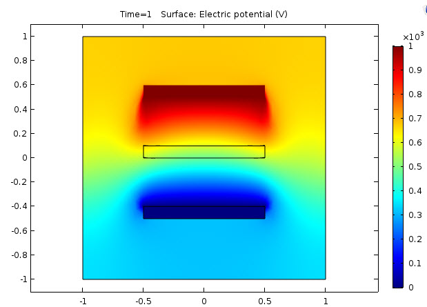

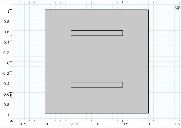

I am beginner at COMSOL. I am trying to simulate electric filed in presence of 2 contacts. A movable contact and a fixed contact. The fixed contact is grounded and the a electric potential is applied to the moving contact. I have used Moving Mesh ALE to move the movable contact. I face a problem. Domain of moving contacts move truly according to the ALE settings but the material do not move! I have attached two related images as well.
