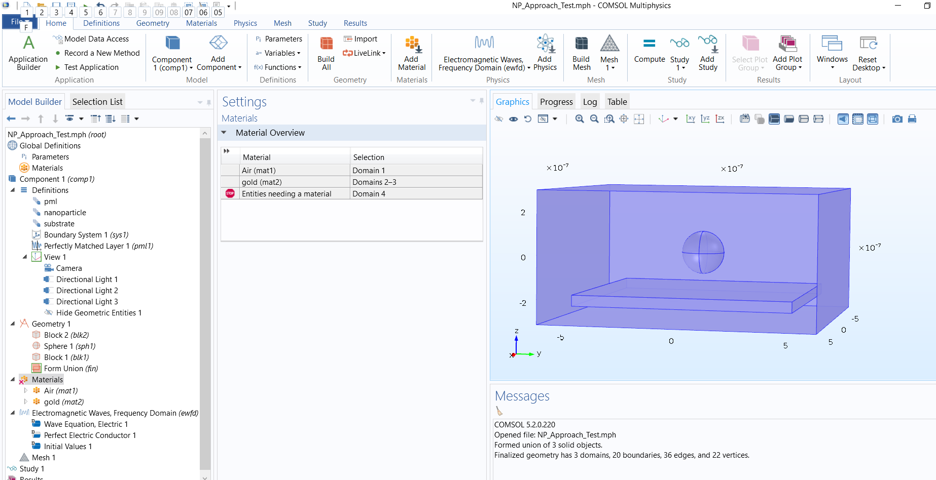

I'm a new user to COMSOL 5.2 and I'm having trouble assigning materials to my domains. I'm working in the Wave Optics module (ewfd).
My geometry has one spherical domain, and two block domains. All of which have been assigned to a material with its refractive index properly defined.
However, I see the red stop sign on the Materials settings: "Entities needing a material: Domain 4". (See attached photo)
But there I don't thinkI have a Domain 4 in my geometry? When I build, the message box tells me my finalized geometry has 3 domains. I can't seem to find it.
Am I forgetting something or have I set up my geometry incorrectly?

I was having this same problem. I even deleted every object except for a single block, but it still said "Entities needing a material: Domains 2-5" even though there was only 1 domain (the block).
I was able to solve the problem by saving the .mph file, closing it, and re-opening it. I suppose during the file-loading process, COMSOL re-evaluates how many domains are present. It is surprising that COMSOL does not do that automatically or at least whenever you click "Build All".

The old off-and-on-again worked for me and got rid of my dubious "Domain -1", I should try that more often. Thanks!

Same here. I have 11 domains and COMSOL complains about domain 12 needing a material.
Solved with the good old off-and-on-again, but I think this needs fixing.
Did not do an exhaustive study, but I suspect it happens when you delete some object from the geometry.
