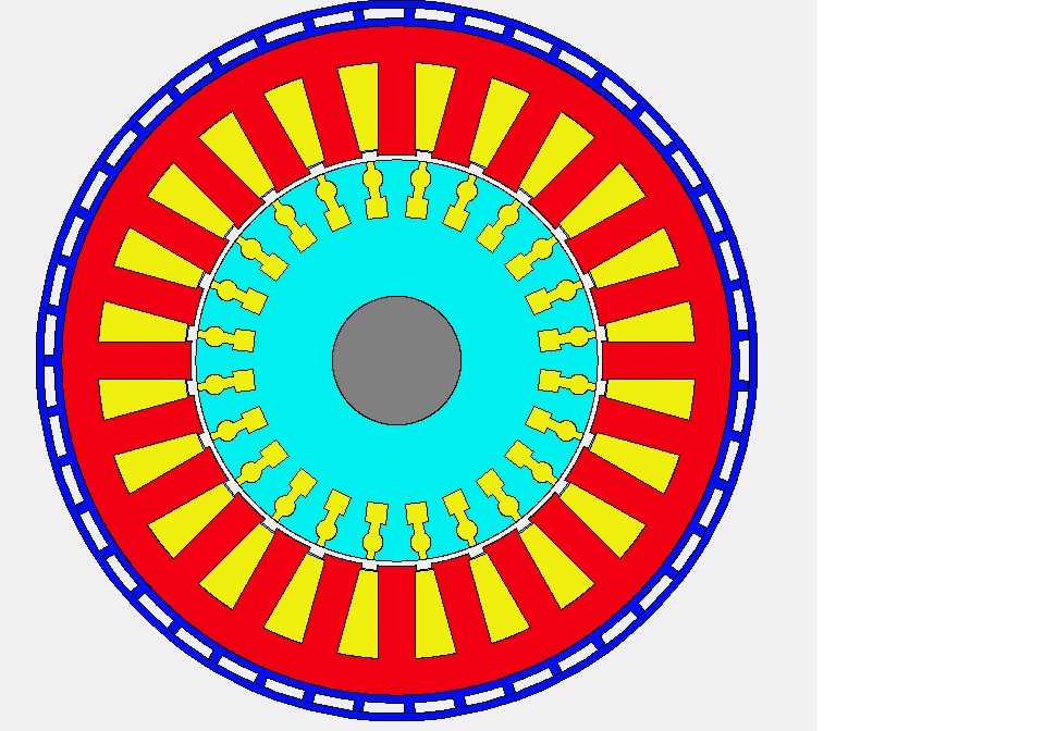

I want to build up a geometry for an induction machine as attached in the following file. I am just a beginner of Comsol's world, so I feel so confused to start with this. I need some suggestions from those who have been experiencing on creating model by using Comsol.

Hi Akmal Hidayat,
The attached geometry was taken from Motor-CAD package. Do you know that? But I can not export its geometry and import into Comsol after several times.
Which kind of CAD license are u using? Unluckily, I haven't had it so far. Is it possible to make a geometry like that by using CAD in Comsol directly?

Posted: 1 decade ago 20.03.2011, 04:55 MEZ
Thank you so much for your kind help. I will try more and if i have some problems, I'll ask you more.
Anyway, do you have any idea on how to draw the geometry like in the figure attached? Currently, I try to use Comsol CAD environment but I feel not easy to do it.
