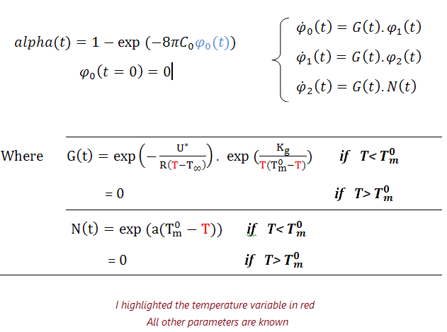

I am trying to couple a system of 3 ODE's with a transient heat transfer study (conduction with a heat source and convective cooling BC)in a VERY simple geometry. I am using the SHNEIDER equations for crystallization.
The relative degree of crystallization "alpha" (0<alpha<1), defined in local variables, is a function of a quantity "phi0(t)" that verifies the Shneider system such as:
name: "phi0" f(u,ut,utt,t): phi0t - G*phi1
name: "phi1" f(u,ut,utt,t): phi1t - G*phi2
name: "phi2" f(u,ut,utt,t): phi2t - G*N
(initial values for "alpha", "phi0", "phi1" and "phi2" = 0)
Where G and N are local temperature-dependent variables defined by simple Boolean expressions under "Model1" [please check the attached picture to see their expressions].
To be more specific, I want COMSOL to compute at each time step the solution of this system giving the value of "alpha" on which depend the material overall properties, starting from alpha(initial condition)=0. This way, I could follow the crystallization process during the cooling phase.
Although it's simple, I can't really understand what goes wrong:
"Failed to evaluate Variable mod1.T - Global Scope" ...... Is it the "alpha" that should be defined differently ?
Any help, clue or idea would be greatly appreciated.
Ali
I think that the problem is that you use the variable T for the temperature field in the definition of variables used in the ODEs. It is not possible to use spatially distributed variables in ODEs that are global equations, so a temperature value in that context must be a scalar value. For a "distributed ODE" (solved in a domain, for example) you can use one of the PDE interfaces with all spatial derivatives set to 0.
To remove the unit warning (orange) in the Variables definitions, you need to "de-dimensionalize" the expression in the exponential for the variable alpha (using C0[s], for example).
Magnus Ringh, COMSOL

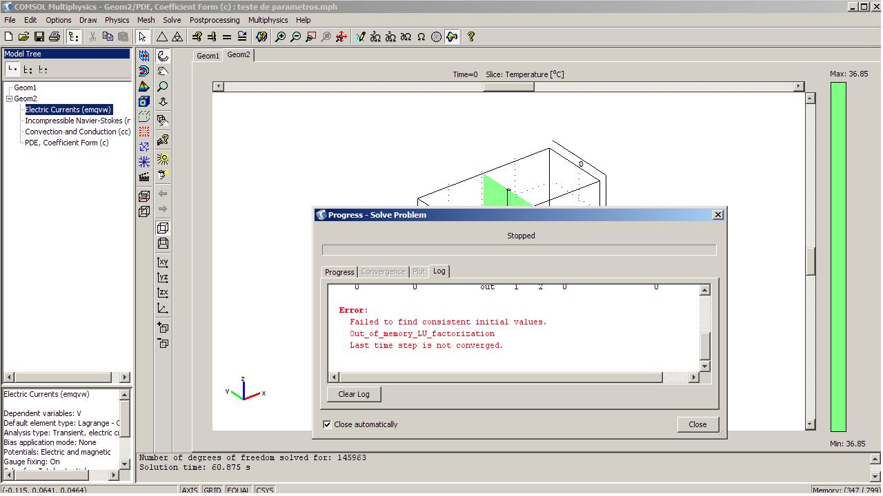

I need help! I am trying to apply an Arrhenius damage integral DURING the solution of an thermal ablation problem using the heat Transfer, electric currents and PDE coefficient form Modules (T, V and u are the dependent variables).
The integral is of the form:
Arrh = integral(A*exp(-E/(R*T))dt)
where Arrh is the Arrenhius damage integral, t is time and A, E, and R are constants. T is the nodal tissue temperature and t is time. I am trying to solve it using the PDE coefficient form Module. However, in the end of the simulation, it appears the following message:
"Error:
Failed to find consistent initial values.
Out_of_memory_LU_factorization
Last time step is not converged."
Any help is WELCOME!
