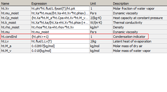

I am modelling heat and moisture transfer in closed chamber using heat transfer module and transport of diluted species module. In order to detect condensation in moist air I used the feature already available in comsol " condensation indicator". However I couldn't find any equation so far about how the "condensation indicator is calculated or the physics behind.
does anyone have any idea about the condensation indicator and how it is calculated ?

Ahmed,
You can find equation for the condensation indicator in the Equation View node, as shown in the attached image. Condensation indicator "condInd" is set to 1 if relative humidity is 1 and 0 if relative humidity is less than 1.
Sergei
Ahmed, You can find equation for the condensation indicator in the Equation View node, as shown in the attached image. Condensation indicator "condInd" is set to 1 if relative humidity is 1 and 0 if relative humidity is less than 1. Regards, Sergei
