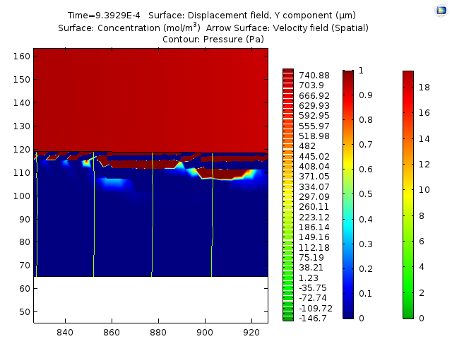

For my problem i have selected the actuation of a flexible membrane. My problem is that at some point during the simulation i see a blow up of the concentration in the area where my mesh is deformed.
Please find attached an image of the situation. I have fixed the color bar of the concentration to get a better view of the problem. If not fixed values for 10^8 and beyond are found in single locations colouring everyhting else as ~0.
My hope is that somebody can give me directions into solving this problem.
Things i tried: - Changing initial concentration from 0 to 1. The result is a blow up at an earlier timestep. - Conservation of mass in the diluted species interface: no result. - Pressure point constraints: no result. - Concentration=0 point constraint at fluid-solid interface where membrane deforms: no result

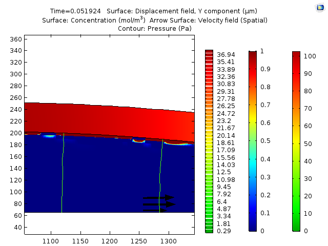

Okay,
Lowering the Reynolds number does seem to negate the problem. However, when i apply a negative pressure at the top of the membrane (creating more deflection) the problem is back.
Okay, Lowering the Reynolds number does seem to negate the problem. However, when i apply a negative pressure at the top of the membrane (creating more deflection) the problem is back.

So i found out that removing the FSI input from the TDS node> transport properties> velocity field removes the problem.
When i plot the velocity of the fluid at the edge of the membrane, i see the magnitude of the fluid velocity passing trough zero. When i plot the concentration with it, the blow up happens at approximately the same spot.
HELP?!?!
Okay, So i found out that removing the FSI input from the TDS node> transport properties> velocity field removes the problem. When i plot the velocity of the fluid at the edge of the membrane, i see the magnitude of the fluid velocity passing trough zero. When i plot the concentration with it, the blow up happens at approximately the same spot. HELP?!?!
