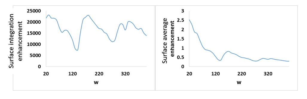

Please, I have a question? I am calculating the electric field in GaAs which has a gold nanostructure on the top. I want to know what is the difference between using surface integration and surface average. When I use both I get diefferent results and I really confused which one should I use to get the real values of electric field in the GaAs.

I am sweping a structure width of gold which placed on the top of GaAs. Light is normally incident on the structure. I want to calculate the light intensity in the GaAs. which one should I use surface integration or surface average to get the right values? I am using this equation (emw.normE^2). I attached two imgs
