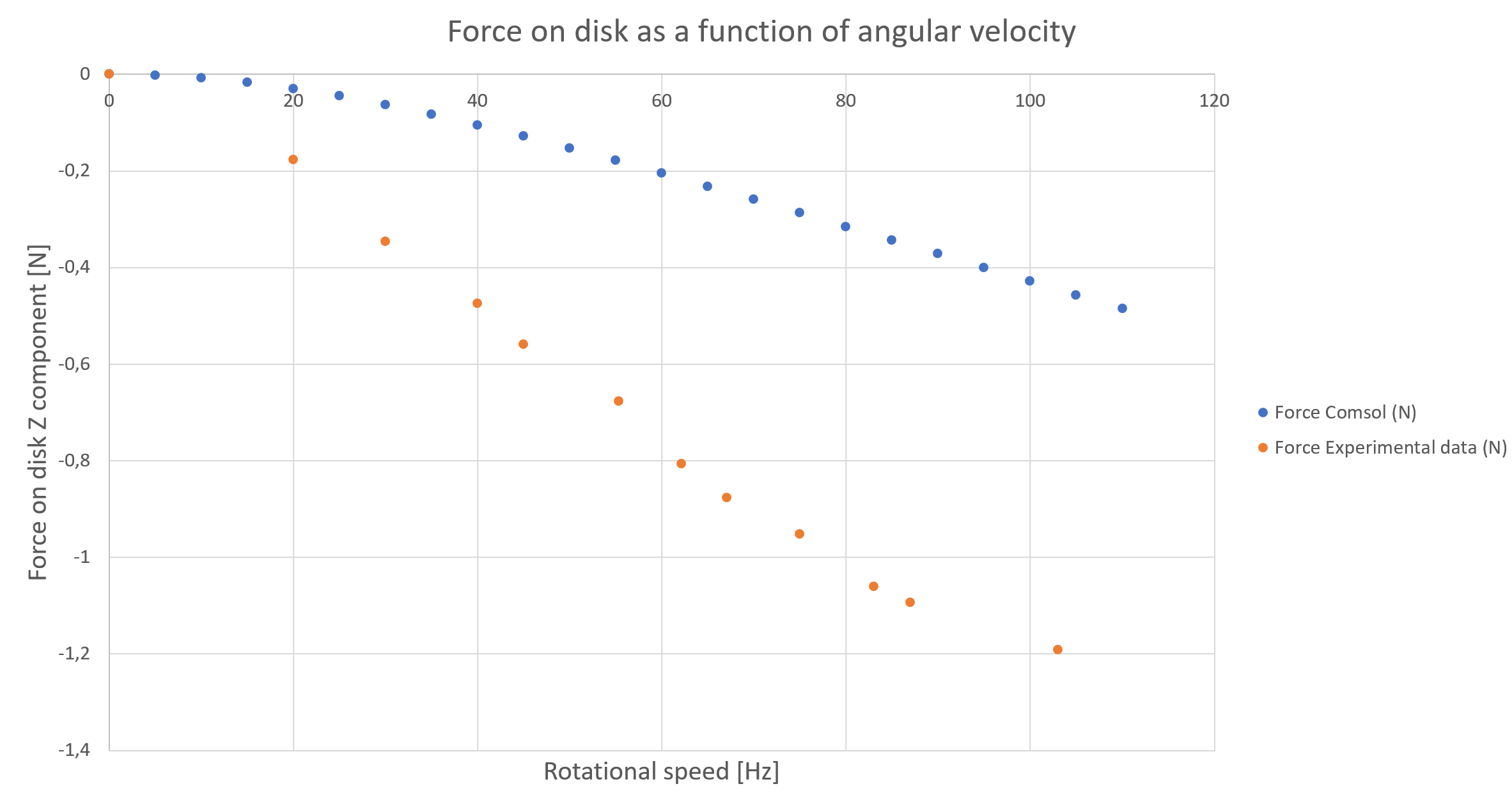

You might be right that the relationship is not linear but I have another problem. The data from the experiments show the force to be much higher than what the simulation predicts. The force measured in the experiment are approximately 4 to 5 times larger than the forces given in the Comsol simulation. I did a quick plot of the simulation and the experiment data in the attached file. Do you have any idea about why the simulation results show much weaker force than the data from the experiment?
Best regards
Mads

Hi Mads,
I have couple of comments regarding this.
  1. The mesh refinement is needed to be sure that the calculation is accurate from the simulation. The Maxwell Stress tensor force obtained from "Force Calculation" node is based on the surface integration on the Disc, therefore, more sensitive to mesh size. However, the Lorentz force is a volumetric integration and are usually more accurate even with relative coarse mesh. Eventhough you are calculating force via Lorentz method, I would still recommend you to refine the mesh in the disc and recompute the solution.
  2. The other major issue here is the the vecocity vector under "Velocity (Lorentz Term)" should have "-2piRPMy" & "2piRPMx". See the attached document of a Homopolar generator examples on page # 15. https://www.comsol.com/model/download/384861/models.acdc.homopolar_generator.pdf
Hope this helps. Best Regards, Nirmal Paudel
Hi Mads, I have couple of comments regarding this. 1. The mesh refinement is needed to be sure that the calculation is accurate from the simulation. The Maxwell Stress tensor force obtained from "Force Calculation" node is based on the surface integration on the Disc, therefore, more sensitive to mesh size. However, the Lorentz force is a volumetric integration and are usually more accurate even with relative coarse mesh. Eventhough you are calculating force via Lorentz method, I would still recommend you to refine the mesh in the disc and recompute the solution. 2. The other major issue here is the the vecocity vector under "Velocity (Lorentz Term)" should have "-2*pi*RPM*y" & "2*pi*RPM*x". See the attached document of a Homopolar generator examples on page # 15. https://www.comsol.com/model/download/384861/models.acdc.homopolar_generator.pdf Hope this helps. Best Regards, Nirmal Paudel

Hello Nirmal
Thank you very much for the help. That seems to have solved the problem.
Thanks a lot.
Best regards Mads Larsen
