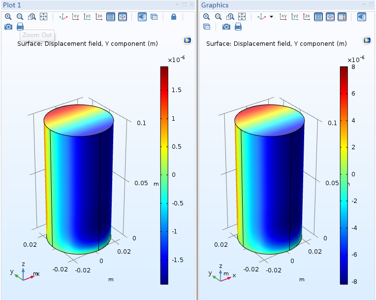

In the example of linear_elastic, D[3][3] = D[4][4] = D[5][5] = E / (1.0 + nu); // lower diagonal, note that this equals 2G For transversely isotropic material , I set the Elasticity matrix D
D[3][3] = D[4][4] = 2 * G13;
D[5][5] = E1 / (1.0 + v1);
but the result of displacement of u and v is different in quantity size from the solid mechanics

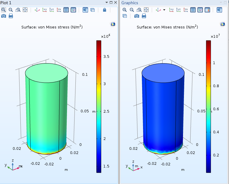

I have rewritten the linearelastic.c program of the example for it can be used to the transverseisotropy Material. There is five input arguments and the D matrix is different from isotropy material. See the appendix in detail.
But there are some differences in the results bettween calculated by External materials and direct calculated by orthotropic elastic. Such as mises stress and strain component. See the appendix in detail.
Dear Henrik, Thank you for your kind response. I get it. I 'm plagued by another problem. I have rewritten the linearelastic.c program of the example for it can be used to the transverseisotropy Material. There is five input arguments and the D matrix is different from isotropy material. See the appendix in detail. But there are some differences in the results bettween calculated by External materials and direct calculated by orthotropic elastic. Such as mises stress and strain component. See the appendix in detail.
