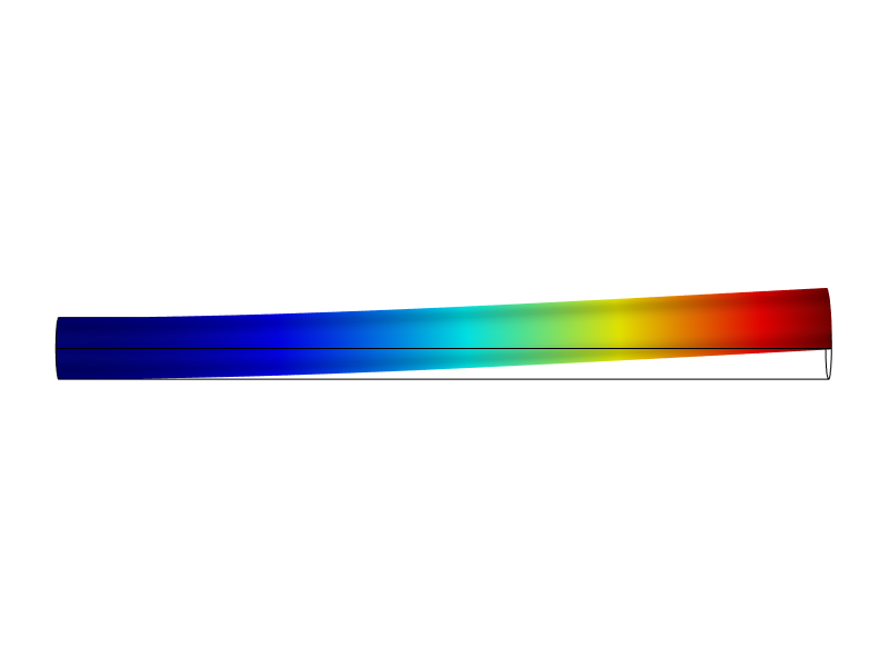

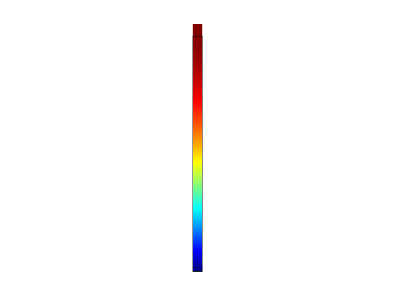

I have a very simple model : A cantilevered cylinder, radius = 0.4m, length = 10m, fixed contraint at the bottom, free everywhere else.
In 2D axisymmetric geometry this cylinder is modeled by a r=0.4m x z=10m rectangle with it's bottom left edge at (0,0).
The 2D axisymmetric eigenfrequency solver only returns the hight frequency compression modes (see image attached), the lower frequency rocking modes are not computed.
The exact same cylinder computed in 3D returns the wanted lower frequency rocking modes (see image attached)
How to computed those rocking modes in 2D axisymmetric geometry.

In 2D axisymmetric analysis both the geometry and the deformation must be not vary in the circumferential direction. The displacements of the cylinder’s low frequency bending modes are not axisymmetric so they cannot be picked up in an axisymmetric frequency analysis.

Starting at version 6.0, the bending eigenmodes of an axisymmetric object can be computed in the 2D axisymmetric interface by selecting the "Circumferential mode extension" option and specifying an azimuthal mode number. Read this blog post for more information on this topic.
