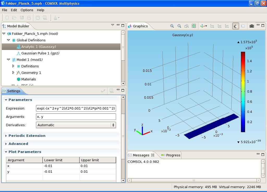

I am trying to solve a 2D Fokker Planck equation using Coefficient form PDE for u(x,y,t).
The initial condtion for the probability distribution u(x,y,t=0)= exp(-(x^2+y^2)/(2*0.001^2))/(2*pi*0.001^2).
which is a Narrow Gaussian distribution in x and y.
when I created this function using analytic function called Gaussxy(x,y)= exp(-(x^2+y^2)/(2*0.001^2))/(2*pi*0.001^2)
and plotted the surface plot for u(x,y) from x={-0.01, 0.01} and y={-0.01, 0.01}, the surface plot is totally wrong.
I have also tried using Gaussian pulse from analytic finction like
Gaussxy(x,y)= gp1(x)*gp1(y) which is a multiplication of two Gaussian pulses with standard deviation of 0.001.
The surface plot of this also give wrong results. I am not sure where I am making the mistake.
However, when I plotted the Indiavidual functions such as
ux(x)= exp(-(x^2)/(2*0.001^2))/sqrt(2*pi*0.001^2) gives a good Gaussian plot in x.
This is true for y also
uy(y)= exp(-(y^2)/(2*0.001^2))/sqrt(2*pi*0.001^2) gives a good Gaussian plot in y.
However, when I multiply them and plot them for x={-0.01, 0.01} and y={-0.01, 0.01}, the surface plot is totally wrong.
is there any other way that I can specify a narrow gaussian in x and y or a dirac delta function in x and y as my initial condition?
I have attached the .mph file with this..

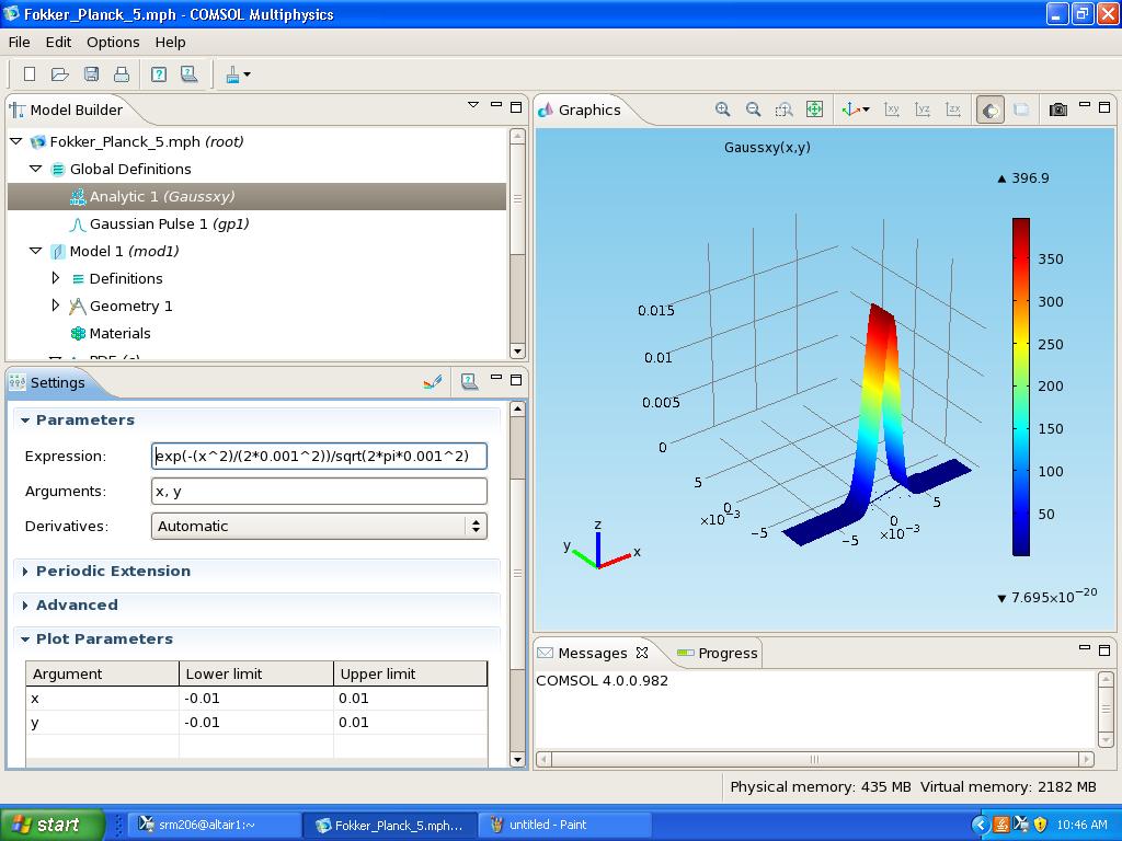

When I plotted
gives a good Gaussian plot in x (COMSOL_Gauss_X.JPG).

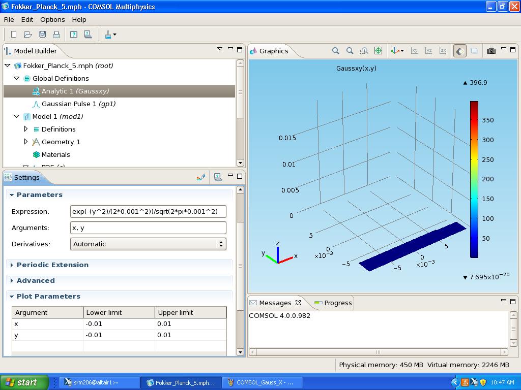

But when I plotted
uy(y)= exp(-(y^2)/(2*0.001^2))/sqrt(2*pi*0.001^2), it gives wrong result. (COMSOL_Gauss_Y.JPG).
also when I plotted
u(x,y,t=0)= exp(-(x^2+y^2)/(2*0.001^2))/(2*pi*0.001^2) gives wrong result.
Could you please have a look at the images that I have attached with this message.

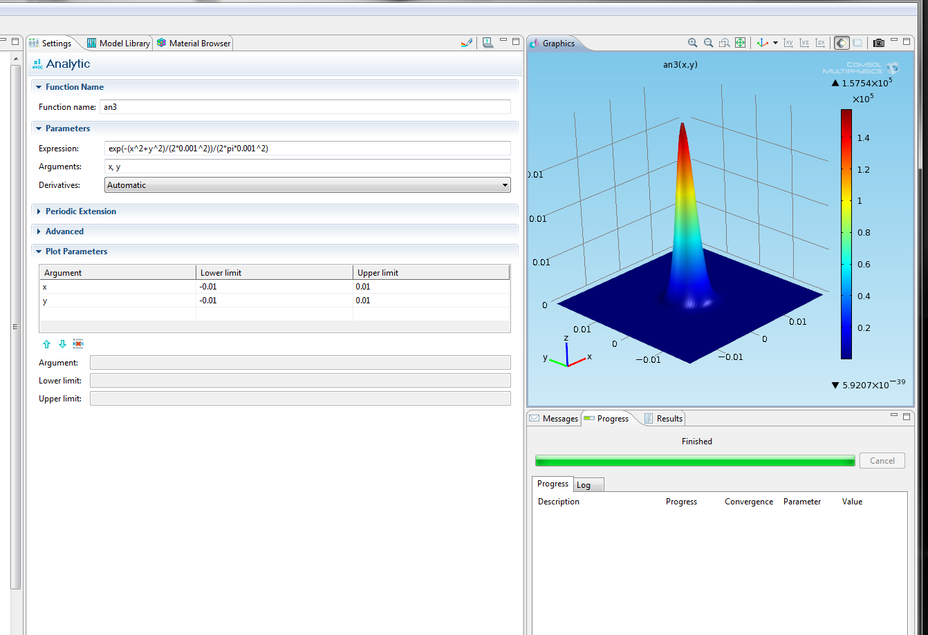

Hi Ivar,
I got a reply from COMSOL support team, they could plot the function correctly as shown in the Figure attached with this message. But I could not get the same result... I think there is something wrong with my graphics or rendering...
Srinivas
Hi Ivar, I got a reply from COMSOL support team, they could plot the function correctly as shown in the Figure attached with this message. But I could not get the same result... I think there is something wrong with my graphics or rendering... -- Srinivas

good question, I too can plot all functions correctly, they correspond to what I get in Maple too, so either you have an issue with your version (have you updated correctly to latest ? or it might be with 4.0, you should reset your model, or better rebuild it fully in 4.1 (and forget 4.0 ;)

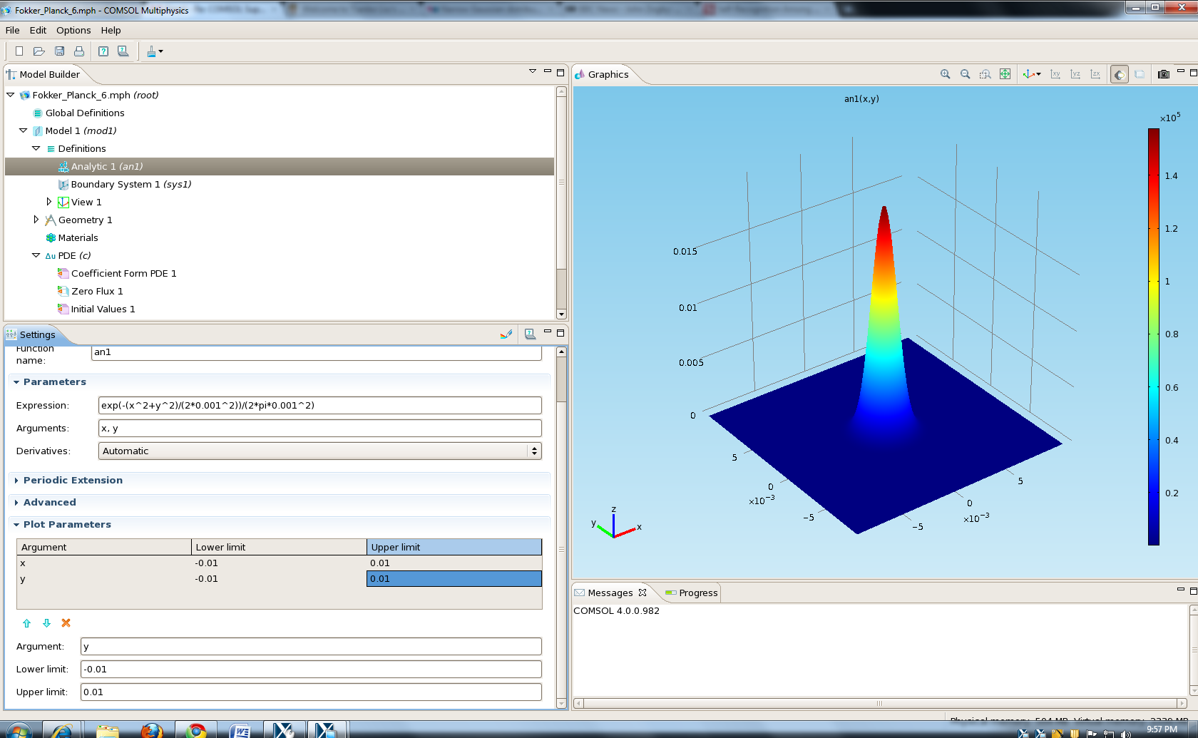

Hi Ivar,
Thanks for the help. It is a problem of 3D Rendering. I had to change the option to software as below.
as told by COMSOL support team
"Options > Preferences > Graphics" and under "3D rendering:"
select "Software" and click "Apply"
Now it shows correct distribution as shown in the attached figure.
