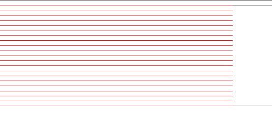

my 2d model has been solved, and 21 additional lines were created on the domain (surface) by " cut line 2D" from "Results" .
Now, I want to get the maximum value of each line respectively, how can I make this?

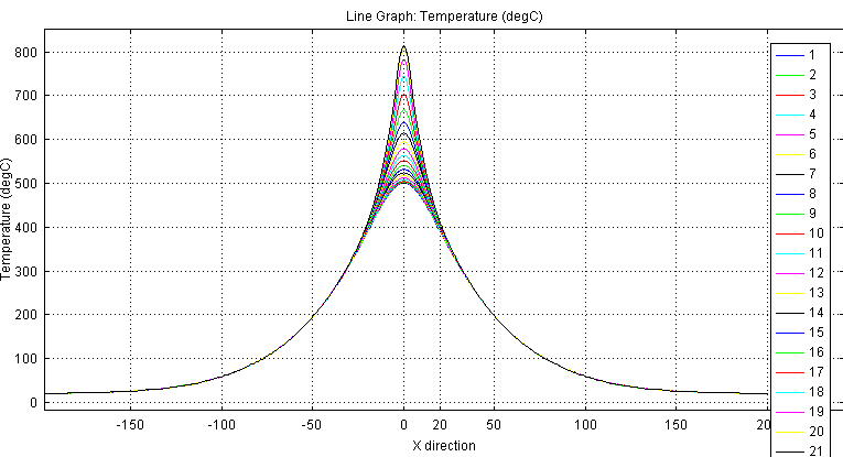

Attached graph was plotted from these 21 parallel lines, my work is to non-dimensional-normalized each line,
obtain the ratio of temperature to the peak value.
