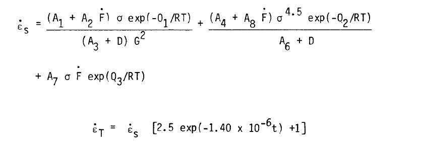

I am modelling thermally induced creep for UO2 nuclear fuel. The stresses are thermal stresses resulting from a stationary thermal and structural study done before the time-dependent creep study. I have two questions: 1. How can I use the stress results from the stationary initial study as input for the time-dependent creep study? 2. I am using a user defined creep model for UO2, and when I choose User Defined in the creep, it asks me for a creep tensor (the model is in the attached image). How to define the creep tensor using the model?

As for the creep input, you first have to decide if the creep process is deviatoric, that is volume preserving. If so, you only need to input a scalar creep rate (by using the Deviatoric option, rather than the User Defined). Since your equation looks scalar, it does not seem like there is any more information anyway. Basically, you just need to type in the expression you attached as the ceep rate, but the stress should be the von Mises stress.

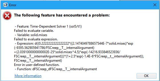

I have used 'solid.mises' as the stress in the expression but I got an error, please find the attachment.
How can I solve this?

Your error message does not really give enough information, but it seems to contain two issues. One is related to a user defined function. The variable solid.mises in itself should be well defined, as long as the physics interface has the tag 'solid'.

I have solved the above problem as I used solid.mises in the creep function not as a global definition.

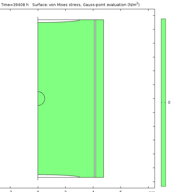

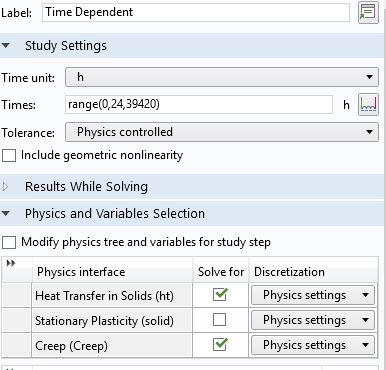

1.In the time-dependent study step, if i solve for the solid mechanics (thermal expansion stresses), the solution does not converge. 2. If I remove the selection of the solid mechanics (thermal expansion stresses) when solving the time dependent study step, the creep stress result is zero.
Any possible issue causing that?

Your screenshot implies that you have three different physics interfaces. That would not be a standard appoach for the kind of simulation you have been outlining.
The coupling between the physics interfaces would become more complex in this case, because you would have to transfer stresses and strains. Is it really needed? If so, you should probably contact support.
