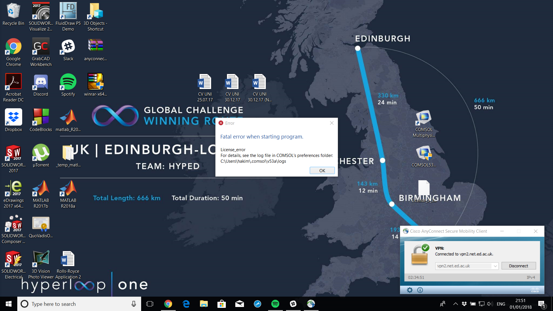

Whenever I try to run COMSOL Multiphysics, a fatal error occurs: License_error.

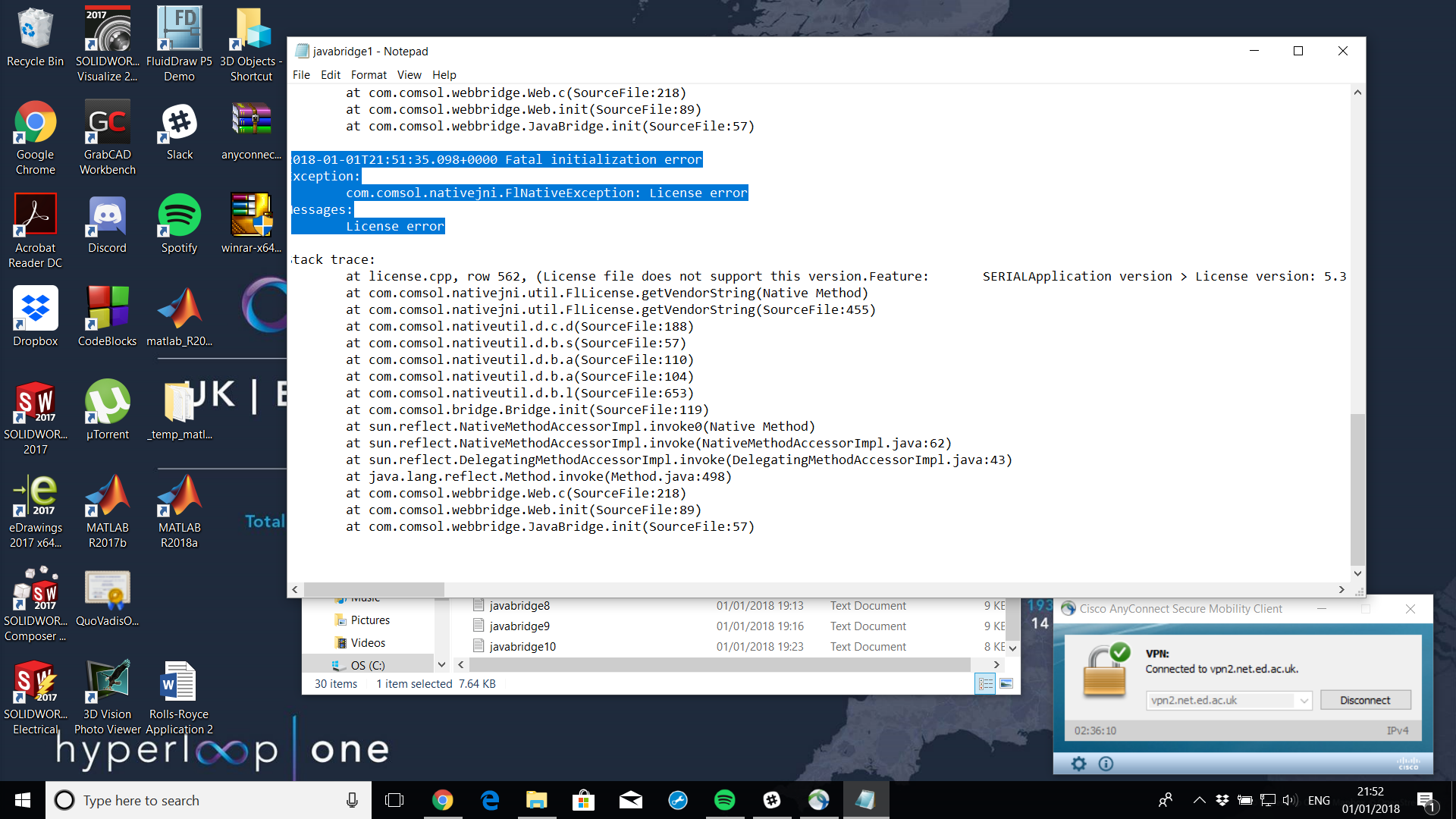

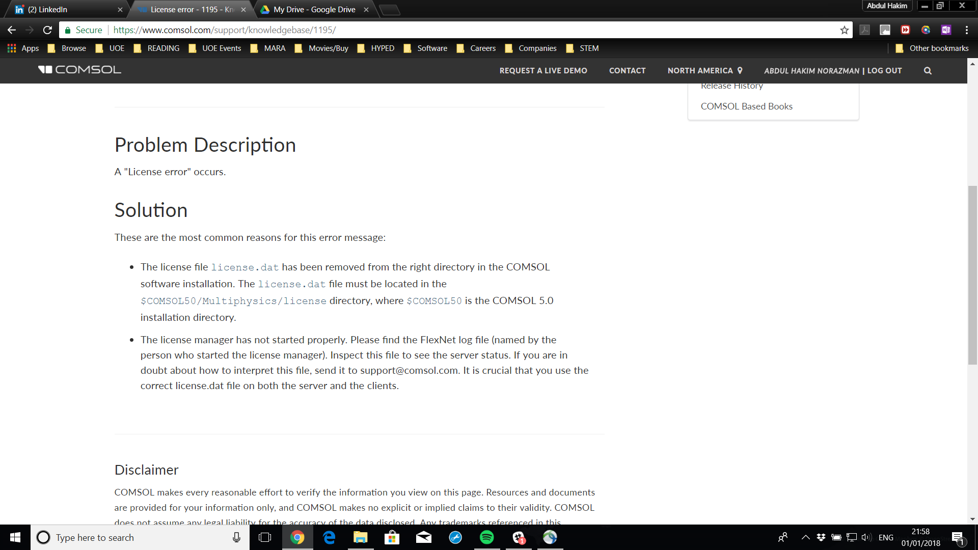

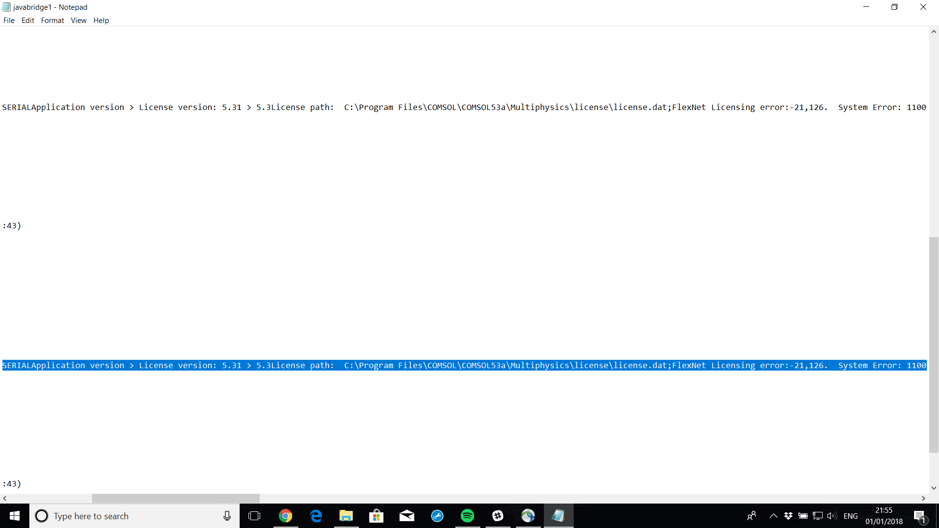

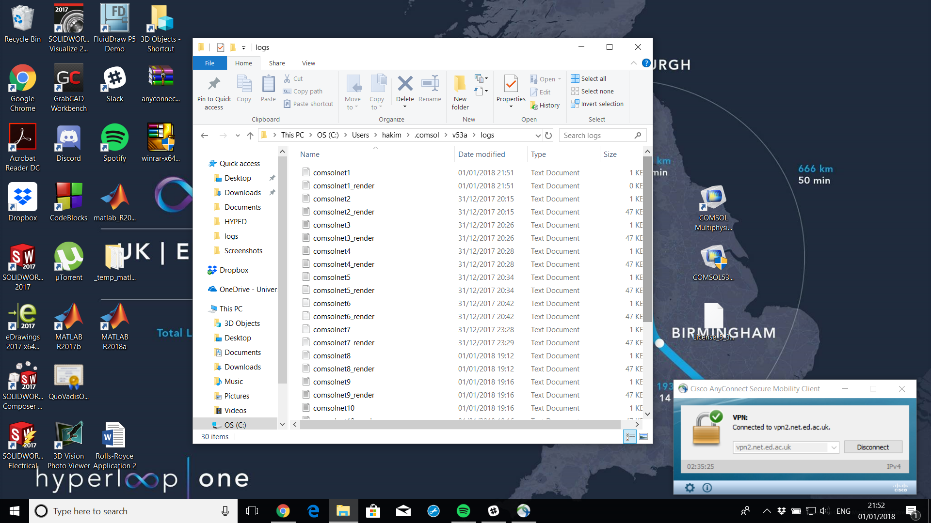

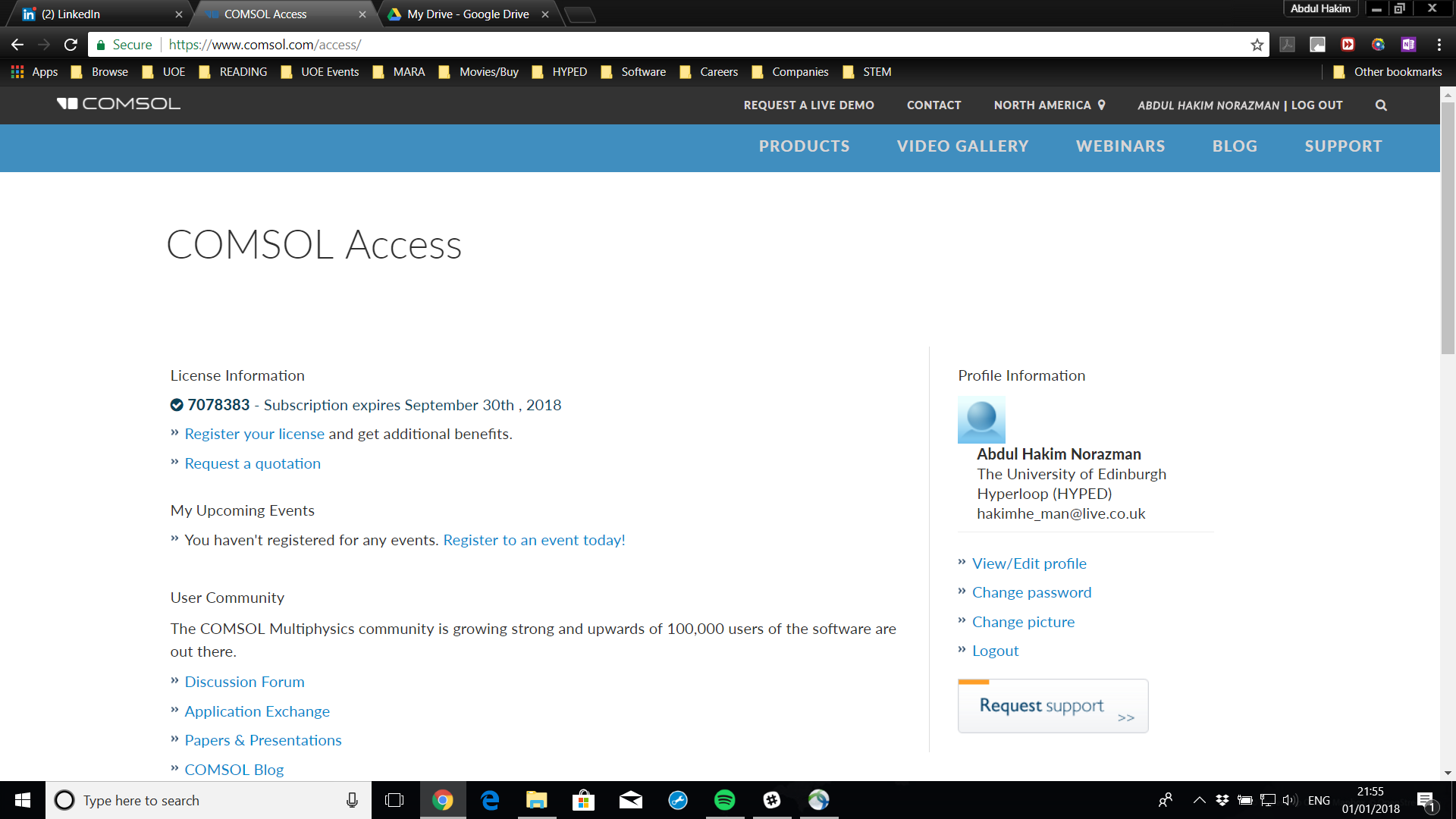

I've attached screenshots of the error pop-up, logs file, notepads in the logs file, license details and a possible solutions page.
I have tried the solutions on said page and reinstalled COMSOL. Nothing's working out.

The error messages suggest that you are trying to install version 5.3a with a version 5.3 license.dat file. Make sure to use the version 5.3a file that was sent to the point of contact of record for your license.
On a networked license, the license file needs to be updated both on the clients and on the license server.

This has solved the error above. Thanks Jeff for your help!
