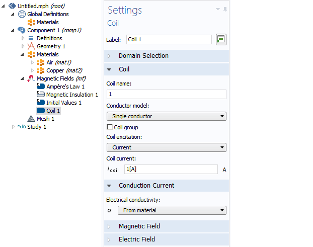

You should use "Coil" feature node, as shown in the attached image. This will account for induction currents in the coil, just make sure to mesh coil appropriately to resolve skin depth, especially if you are working with high frequencies.

Daniel, You should use "Coil" feature node, as shown in the attached image. This will account for induction currents in the coil, just make sure to mesh coil appropriately to resolve skin depth, especially if you are working with high frequencies. Regards, Sergei
