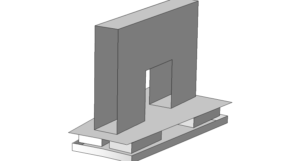

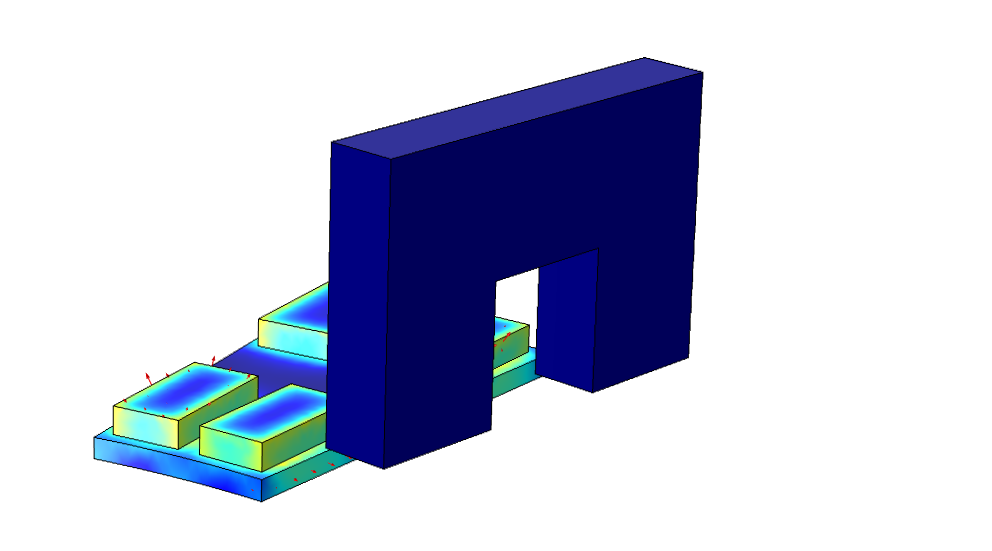

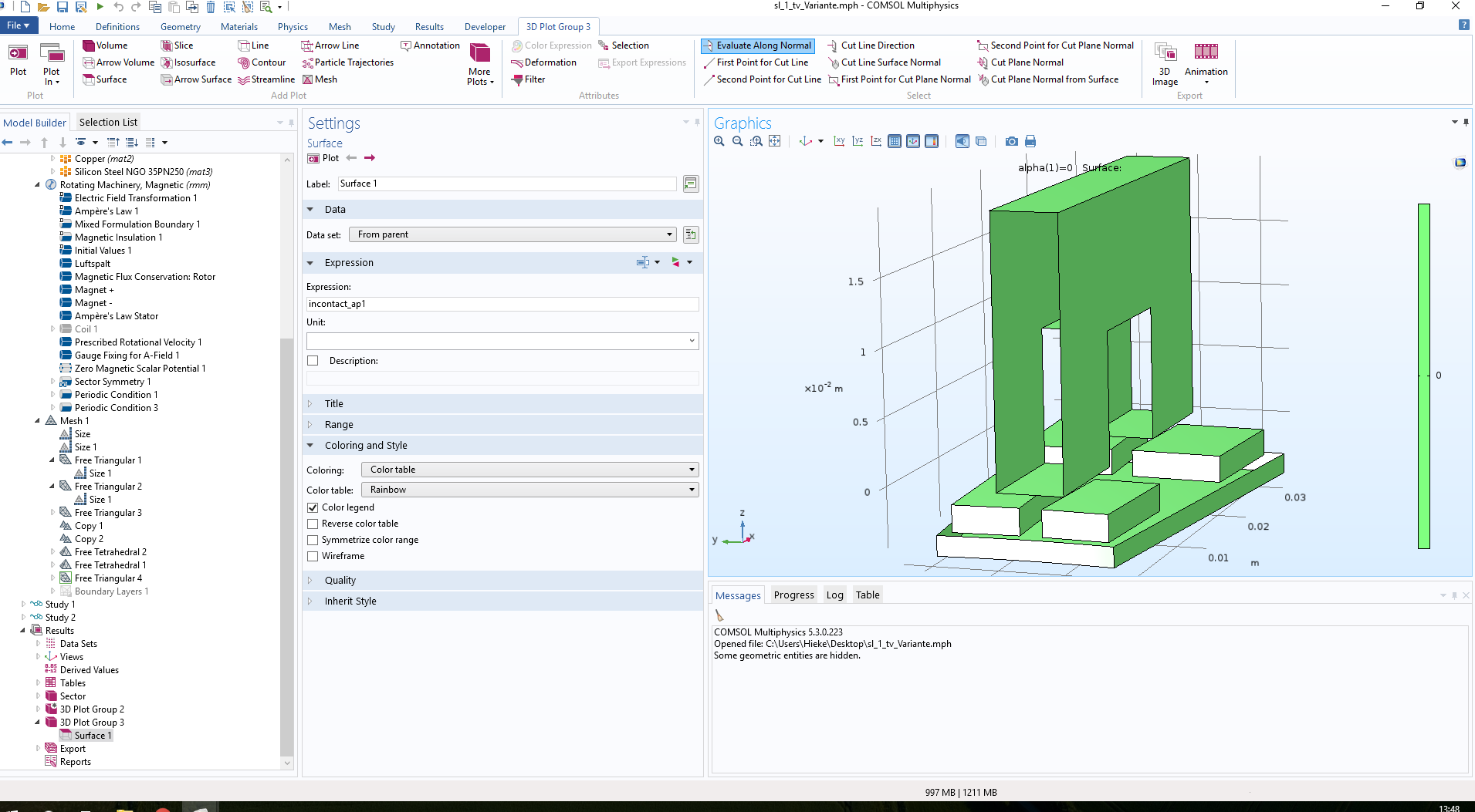

                                                    Hallo,
i made a plot with the the expression. The first picture shows the identity pair (between U-core and the 4 magnets) and the second the plot with the expression. Obviously i made a mistake, when i applied the axis of rotation.
Is it possible to plot all of the sectors?
                            Hallo,
